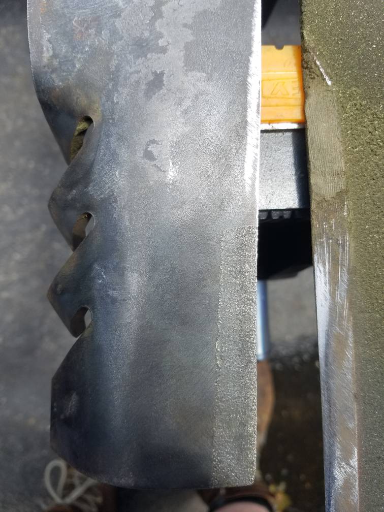

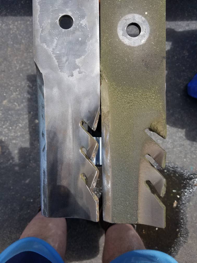

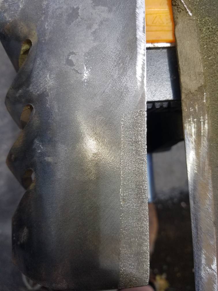

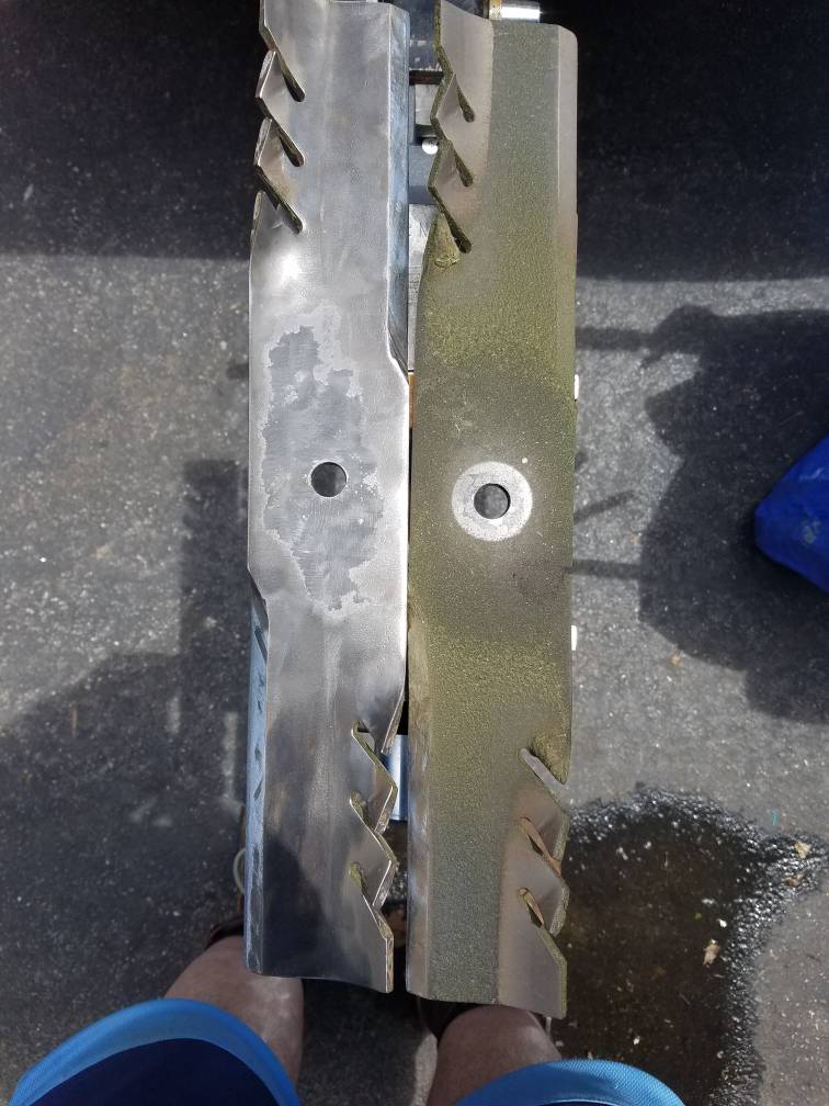

I took a few photos of my G6 blades. You can clearly see the Fusion on the blade ends.
I wire brush the grass off the blades then sharpen by hand. [emoji106]

Explain the term "fusion" and how it relates to the blade. There is no sarcasm in my question -- I just want to know. I just removed a set of Gators from a walk behind zero turn we have because one of them caught a root and was slightly bent. I replaced them with high lift blades and the high lifts work marvelous for wet grass.

I think it is just some different metal that is harder and holds an edge better. The Fusion part is the little wavy portion at the tip ends of the blades on the underside. The website may be able to explain a little better than I can.

"Fusion" is basically hard weld on the lower edge of the blade for about 1/2" back. This makes just the edge of the blade harder so it stays sharp for longer but they are more prone to chipping if you are hitting rocks.
