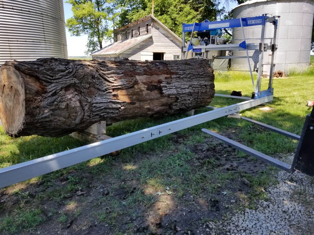

What do you set the rakers at for a ripping chain. Using 27RX 404. Just seen a comment on Lucas page. Said rakers are not really needed for ripping chain. Take them way down. Not so sure about that.
The log in the picture cut really so. First half of log was ok but the second half was very slow. 12 minutes was longest cut. 13.5 ft long.

I can see all the ridges, what angle is on the top plate ? 5/10* is better for a smoother cut I remember the bigger the angle on the top plate the more the chain is pulled sideways . I have set the rakers to about 30tho, if its cutting slow, and it’s kicking out fine saw dust you can take them down a bit more, your looking for bran type stuff not flour

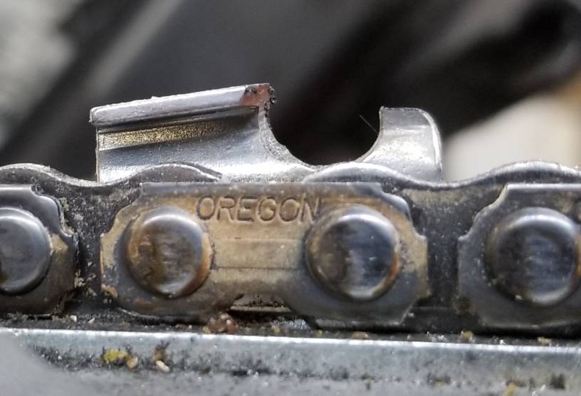

Any recommended file guides? I'm pretty handy with a round file, but square is take some practice for me.
IMG_20180915_141327.jpg Simmington showed me how inconsistent I had gotten with a file on square. This is the last of a reel of LGX I have made loops from for two years now. One more long with some replacement pieces for the "found that horseshoe!" sections. A retired teacher in Perth alleges the feed consistency and steady angle of the bar to the direction of travel are second only to sharpness (including depth guage angle) . IME comparing comp ripping with skip chisel ten or twelve days later there was no real visable difference.
Your mileage may vary!
Now that I can make a chain equal around touching up in the field will work out fine. I feel for the angle & try to match that while watching the files corner relation to the chisel outside corner. Works two or three times inna row before it's less help than the first time. That may just be me.....
The arm of the grinder is high so that the tooth leans for a more blunt angle behind the edge. A sharp angle will cut fast and lose the edge fast also.
Enjoy milling safely

Any photos of the cutters?
