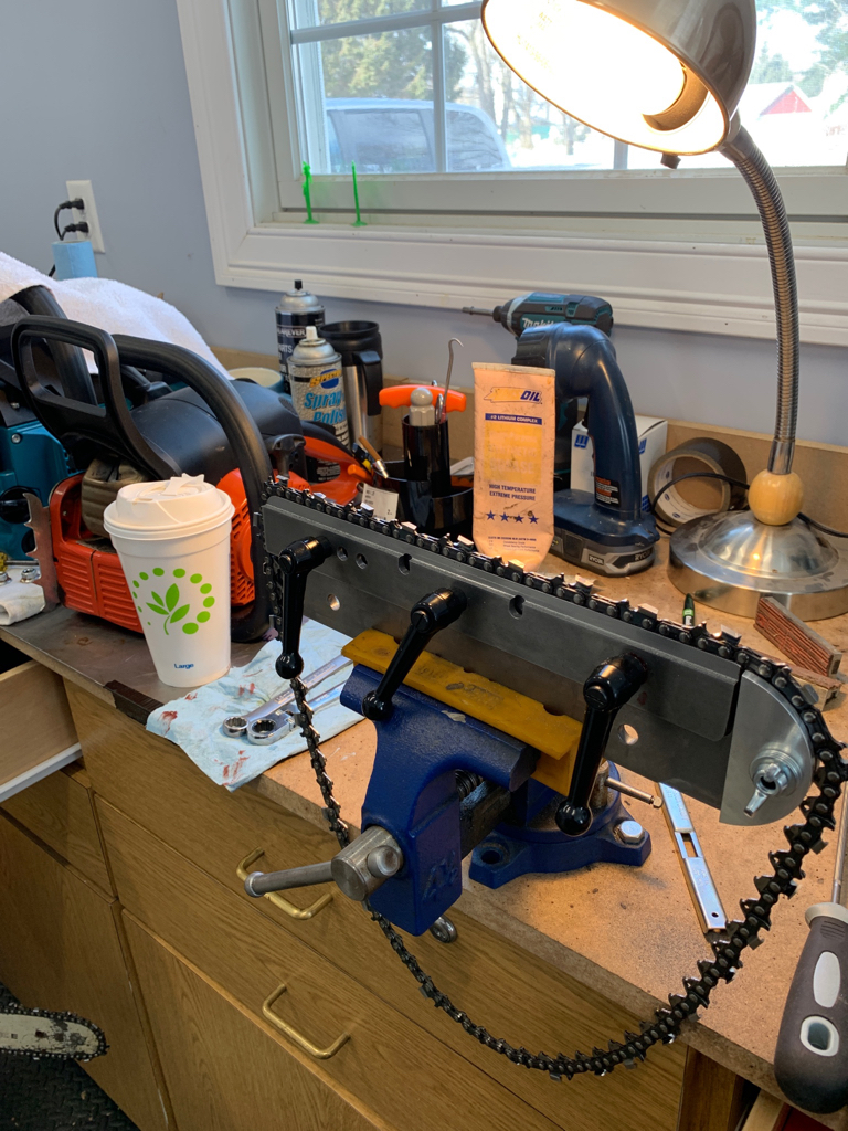

Love this thing. I think I found every chain I had around and sharpened it even on the saws I don’t plan on using anytime soon
I put my chain in the vise like you....I find that it will smoothly pass through when run this way. I have seen a lot of pics of the chain going in the other direction (chain going in direction of the radius) but the links get hung up on the square end of the vise.
The thing is soooooo nice though, love how it holds the chain solid. I also got a Timberline sharpener but I'm having trouble getting it setup correctly. I keep hitting the cutter stops on the Timberline when I grind one side of the cutters.
I sharpen the the right hand cutters with the chain in that direction, then turn the chain around to do the left side cutters.
It does take time to completely take the chain out of the vise and turn it around, but how else could you do it if you can't stand on the other side of the vise???

I sharpen the the right hand cutters with the chain in that direction, then turn the chain around to do the left side cutters. It does take time to completely take the chain out of the vise and turn it around, but how else could you do it if you can't stand on the other side of the vise???
Some vises rotate.
Some people might have the chain vise mounted on a board: take it out and reverse that in the vise.
Vise at the corner / end of a bench might have access on both sides.
Different strokes for different folks. As long as you find something that works for you.
I'm able to stand directly over and behind the chain and can sharpen both sides doing it this way. My bench vise is on the corner of the bench and also swivels.
