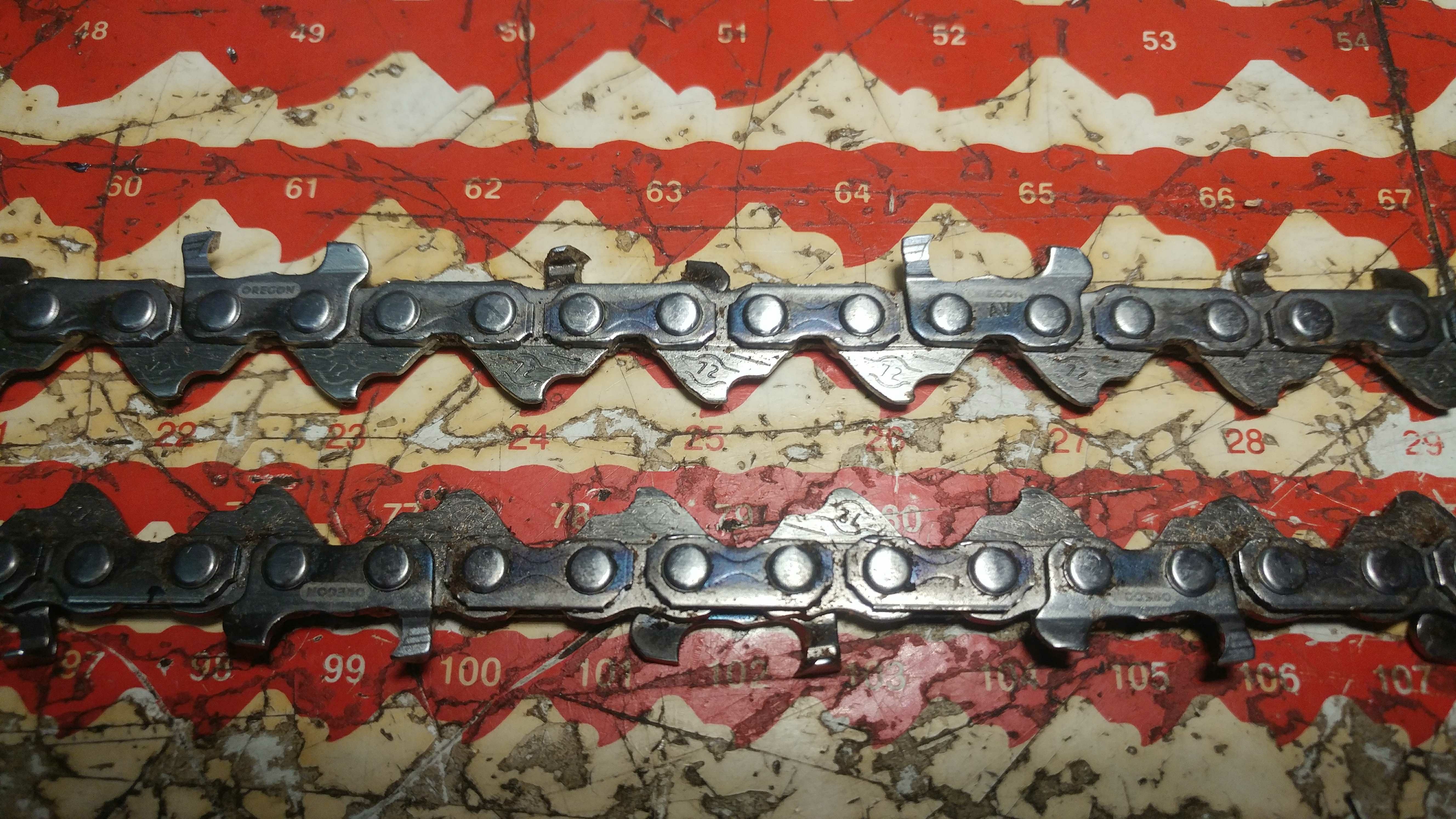

Funny you ask now... I’m cutting with it and the 3601 this afternoon. I just stopped to lower the rakers on this chain @166 Steve sent me to try out. I have about 3 tanks through it. Chain is holding its edge in some dirty wood, but I feel I’m pushing more than I like.

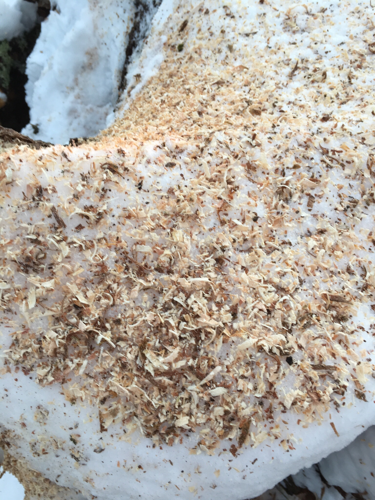

Put another tank through it. I’m liking the chain speed, but it could use a little more grunt. Perhaps when it breaks in good it will have it? Or maybe a muffler mod is all it needs.
This new chain is Surprisingly resilient. I cut quite a bit of dirty wood and it’s still giving me this
But it’s time to take it to the next level. I’ll be square grinding it before I use it again.
That’s what I’m used to so I’ll have a better judge of the Saw.
How many tanks do the 6100’s usually take to break in?
It was 8-10 tankfuls and it seemed to be gaining more power every time
Some of that chain got out with the rakers not to spec. @Spike60 and @afleetcommand had this issue.
