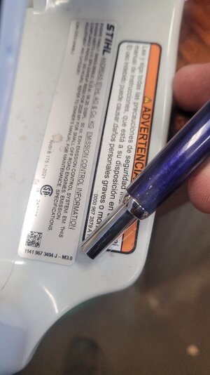

got 2 661 stihls. Both i have no history on but.
neither will got into reset either method,, no label on saw foot.
