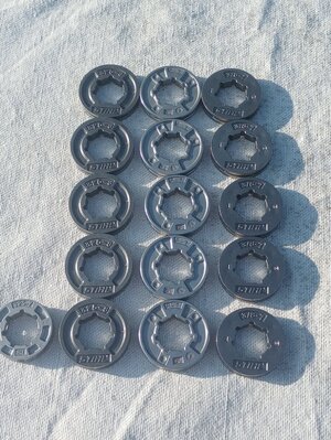

Memory is a bit foggy But the drum bearing needs to checked when swapping drums. The 034 original was smaller OD. (or something like that.)
I got 4 after market rim/drum/bearing kits once and the bearing cage was plastic and stood to tall. The E clip couldn't get in the groove. Sand paper on a flat surface and hand sanding fixed it.
