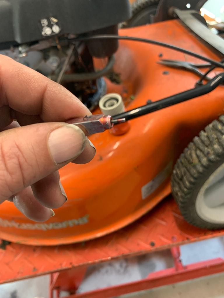

Discovered the fuel shutoff was leaking. In the process of messing with it I noticed black debris coming out the hose into a catch can when I turned it back and forth...it must be coming apart inside.

Got the new shutoff, next she’s getting nothing but RACE GAS

Just as I figured, bad o ring.
Looks like the valve would be repairable with an ethanol proof O ring.
