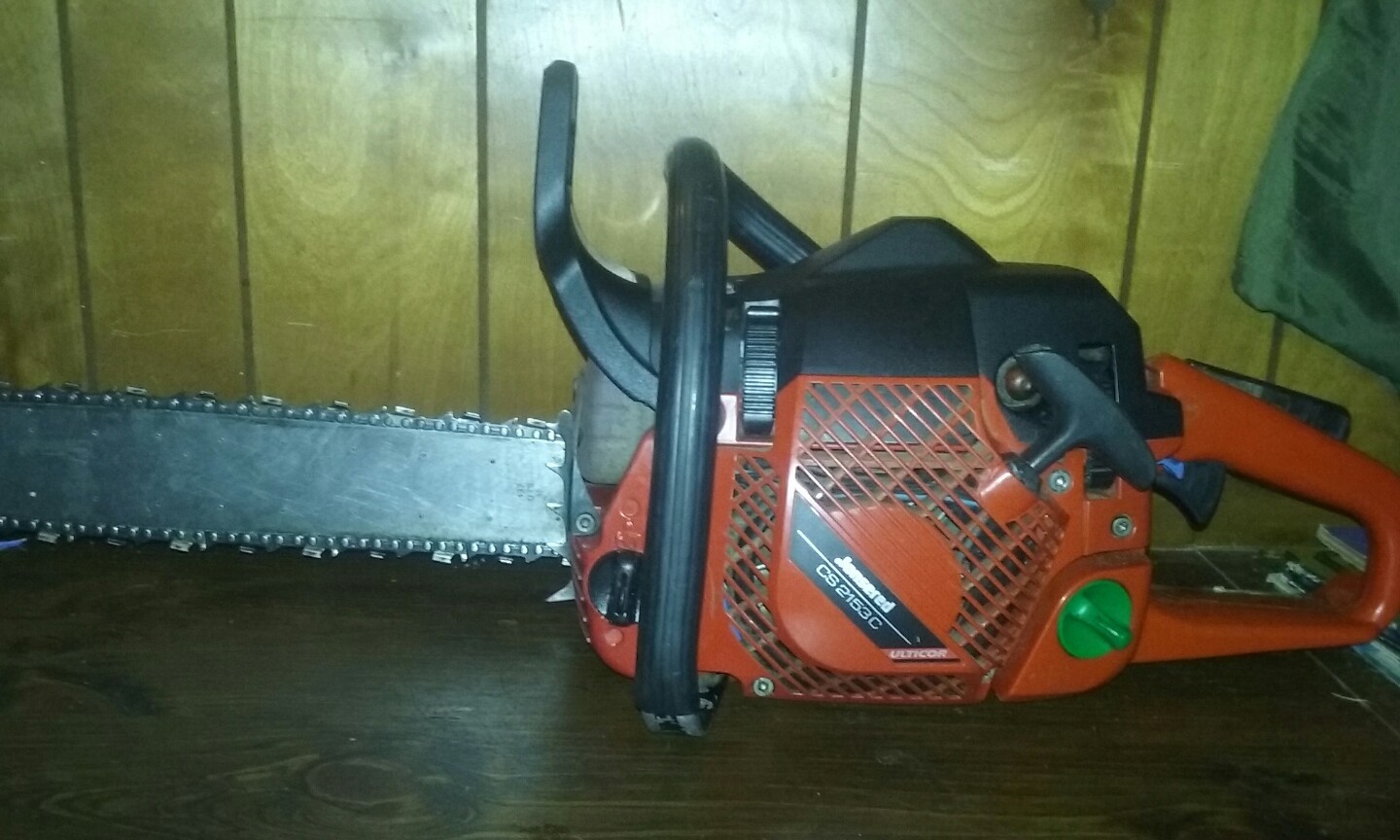

Just picked up a 2152C from Chipper1. Runs good, clean low hour saw. Has some slight wear on the bottom of the handle, but the stickers are still on the bottom of the saw. OEM (Husqvarna cast into side of) cylinder and piston, never been apart as far as I know.
Will be seeing what the piston looks like since there is/has been a lot of hubbub surrounding whether cat mufflers cause overheating and scoring. Has the metal intake boot clamp. Has been run with 42:1 mix. I will be running 40:1.
Runs good now, but have plans for the mdavlee modified 3/4" pipe outlet muffler to go on it... going to put 3/8" chain, and 16" bar on it, 7 pin rim.

Here's the pictures... the last one shows the bottom. There was another sticker on there but it got rubbed off on the ride home. Took a rough road home. Fun when a wrong turn takes you somewhere you usually wouldn't go.
Cat muffler is definitely a choke point, tiny holes in the baffle separating the cat element and the exhaust port, then the exhaust has to flow through a 3/8" tube to the outlet under the deflector. Not doing favors for letting the saw breathe.
I suspect a decent improvement in power from just swapping the mufflers. Will run it and retune it once I get a bar and chain on it and can bury it in a piece of ash.
