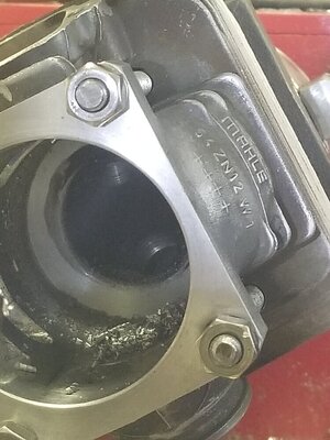

When you sit and really think about it, it’s quite difficult to make a bore unsquare to a base on a lathe with a mandrel. One has to be off quite a bit to actually get more than .0005 difference side to side.
A belt sander is a horse of a different color. IIRC, this jug base was off over .0090.
View attachment 421947View attachment 421949
I think I found something similar on another saw from the belt sander bandit.

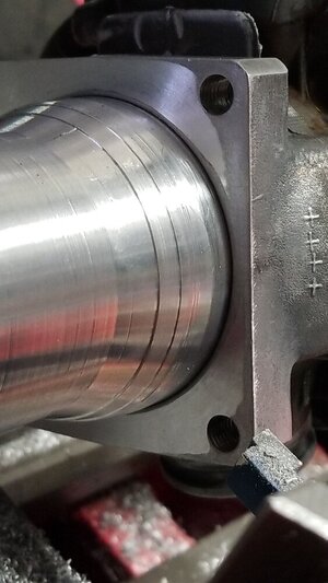

It all starts with good prep work making our base plates, mandrels and cutting tools for the job at hand. An old machinist told me years ago, the tool you need the most is the one you have to make, so make it good.
Some years ago now, I had several new saws come through that the base was significantly off from the bore. After double checking my triple check to confirm 100% that was the case, those saws were indeed saved from some amount of suffering run issues later on no doubt. Then just as fast as they came the problem cylinders disappeared and I haven't seen any since.

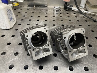

have run into builds where the previous builder did not square up the base in relation to the bore.
I trued a couple up that were sent to me, one belt sanded and one turned on a lathe. To my surprise the sanded one was only a couple of thousandths of an inch out, whereas the lathed one was thirteen thousandths of an inch out.
So, it is possible to fugg up on a lathe although I don't know quite how one would manage it and not see the mandrel not turning true.
Maybe if you don't give two chits.
I have 2 CNC mills but I still prefer to cut the base on a lathe with a proper mandrel. It takes less than 5 minutes on a lathe and I can get a better finish than factory. Solid aluminum mandrel, positive rake carbide and a spritz of wd40.
Husky 5 series saws are notoriously hard to get a good surface finish on. They are really imbalanced from the large front fed transfers which also makes for a heavily interrupted cut for a long while. Also the material has a real tendency to smear, you can't cut it dry.
Yes, a fine job can be had from just a lathe. A milling machine would be nice, especially a cnc, it's not going to happen though between costs and shop room to have one.
Have a cutting tool made up just for turning the bases and it works best cutting in a forward direction, it can be dragged for a one or two thousandths finish cut without issue. I also keep the feed up and not too slow, this also seems to help on the 5 series to get a fine finish on the base.
