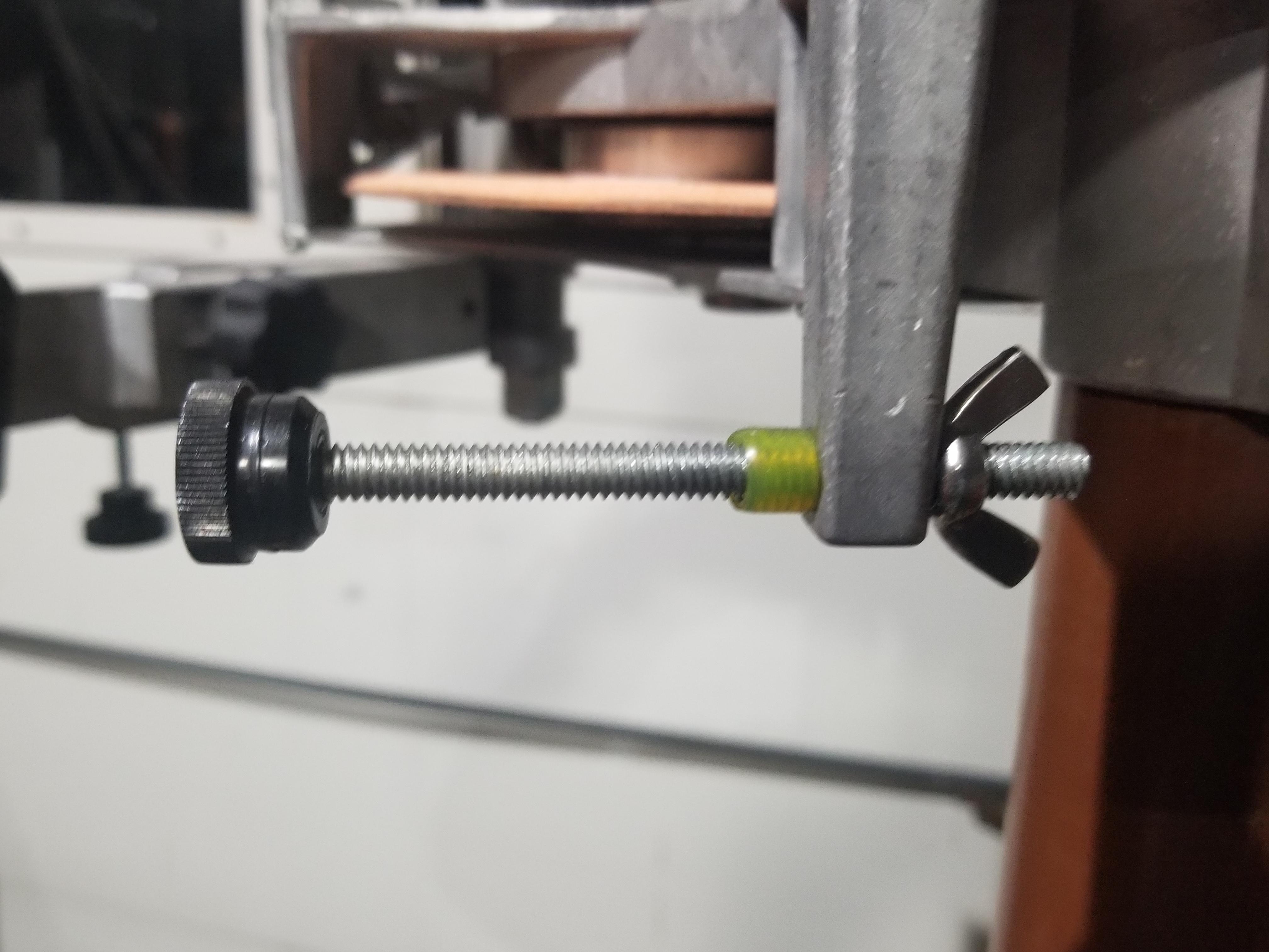

Oh yeah, I got that part down. It's just I wasn't paying attention to what notch or marker point I had it in.
Also tomorrow I am going to pick up some wing nuts to use as backers on some of screws.
I just use a piece of fuel hose to preload the threads, keeps the adjusters from moving and keeps it easy to adjust

That’s a great idea. I’ve got one side stop bolt that vibrates loose all the time. Drives me nuts
