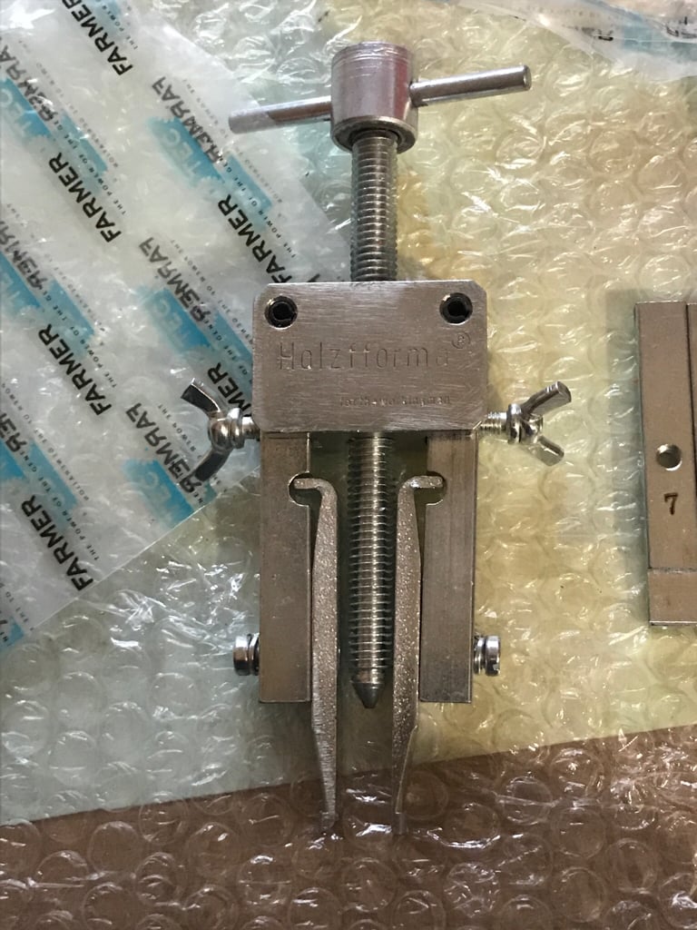

As promised, here it is, it isn’t machined as nicely or quite as precisely as the Stihl tool, but I don’t see any reason why it won’t work just fine.
that's a "dead nuts" copy of the Stihl tool. GLWT.....

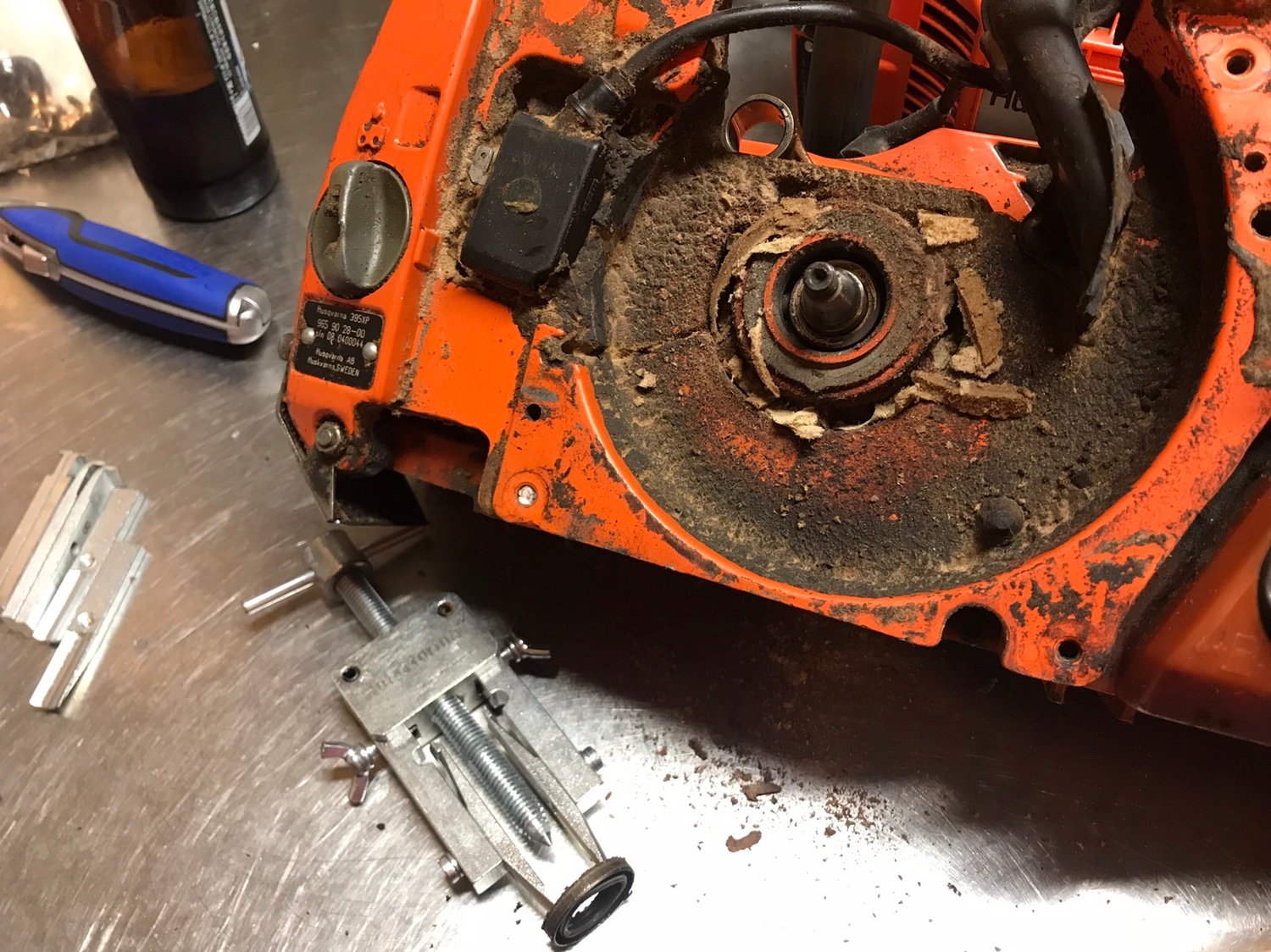

I got mine today. I was so anxious to try it out I had to pull out a saw destine to be torn all the way down just to see how it worked.

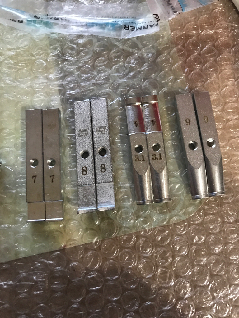

No we need to start a thread with what tips work best for a saw. I started with the #1 tips but I couldn’t force them into the 395 flywheel seal. I ended up using the #3.1 tips and they worked great.

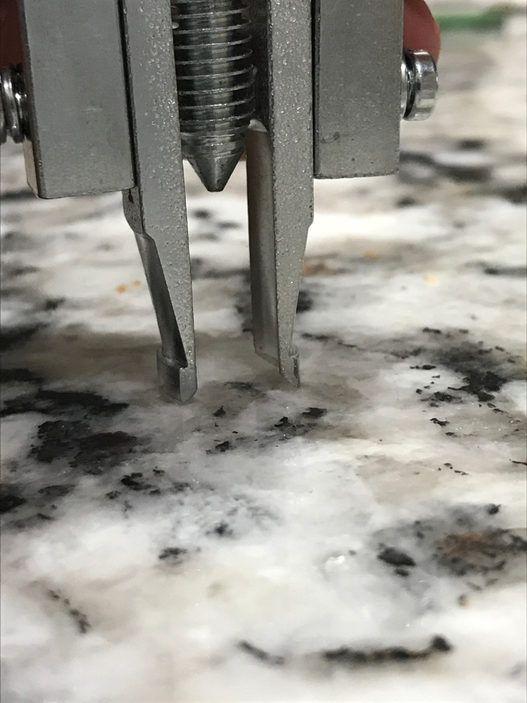

Hey guys,
Remove the thumb screws and replace with torx screws, provided they are tapped to 5mm. like Stihl's tool. You are able to push arms out much more easily. Don't over do the tightening!!!
