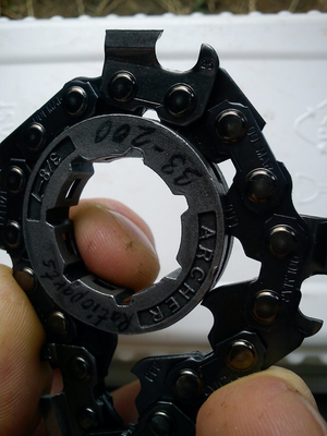

I have a large spline Archer (RatioParts) rim that was sold to me as full size 3/8" - but it doesn't fit more than two DL's properly.
Oddly enough, it fits 3/8" LP all the way around nice and snug.
I have posted pictures of it on here somewhere.

I found the post. @Wilhelm
It looks like this rim of theirs with the 3/8-7 marking is the LP version.
Not surprisingly, the full 3/8 doesn't fit it - due to its larger diameter.
As I wrote in their catalog there is only one version of the 3/8 rim for small spline drums. It has the designation RSM-375-7 and in the application guide they have no problem recommending it for all 3/8 chains (standard and LP).
They also have a chart where this rim is supposed to match the 18720 Oregon rim. This Oregon rim is obviously designed for 3/8 standard chains - Oregon does not have a dedicated rim for 3/8 LP.
The picture of the “Panther3/8 Lo Pro Sm rim from chainsawbars.co.uk (I linked) doesn't have the LP (or similar) designation either, and it's only 3/8-7. It wouldn't surprise me if the Archer and Panther rims came from the same source (in China).
This is another example that various documents must be approached with great caution. There is a lot of misleading information in the documents/websites of Stihl, Husqvarna, Oregon, so bad information in the catalog of a company like PMD is even less surprising.
