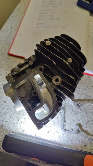

I have always wanted to try porting a 2 stroke engine so I decided to start with my saw. Something will be the first and this is it. I don´t have much skills so I only want to use file, no lathe. The plan was to start easy and measure what I do. I would like some kind feedback of what can be done better and why :)
I started with muffler mod and keeping the original mesh.
My exhaust opened at 104 degrees, but I missed to check total duration.
My intake opened at 72 degrees but I didn´t check total duration.
Squish 0,62mm (0,024 inch)
The plan was to be easy and open at 102 degrees but I chamfered a bit much so it became 98 degrees. Port is really open at 100 degrees.
I also lowered the intake floor to 79 degrees. Things happened much faster than expected.
I took away a little bit material from the lower transfer.
All edges cleaned. The exhaust could be polished better but I don´t know with what.
This is how it looks so far.1000074225.jpg1000074226.jpg1000074227.jpg1000074228.jpg1000074230.jpg

You don't want to read the chamfer on the port opening numbers, you want when the port roof will open. Some people use a really thin feeler gauge and read right when it's bending into the chamfer.
With the exhaust so high you'll want to raise the transfer to support it. Strato saws, with the back filled transfers, really like short blowdown. I like around 116.5° opening on shorter exhaust than you have which yields 13.5° blowdown.

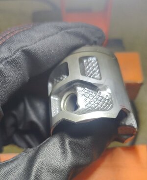

Lower transfers - Red marking is a very ugly edge. Does it make any difference if I straighten that to match the channel?
Green marking - I guess mixture will hit this edge? I just took a little bit here but I guess oval shape could be done to have different flow. But is it good?

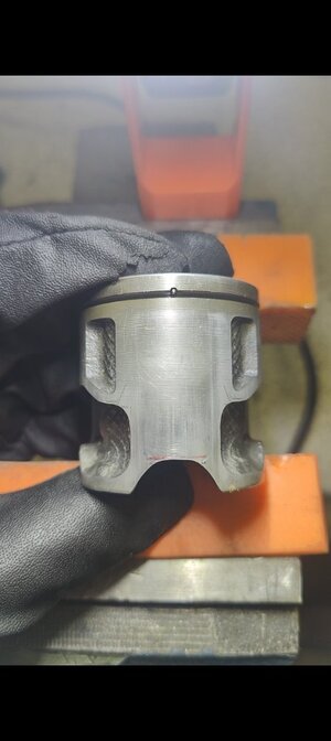

More testing
Wider exhaust. 29,2mm wide or 63,5% of bore. And adjusted to 162 degrees.
Rounded corners
Matching my added intake duration
162 degree intake duration
Intake 162
Exhaust 162
Transfer 122

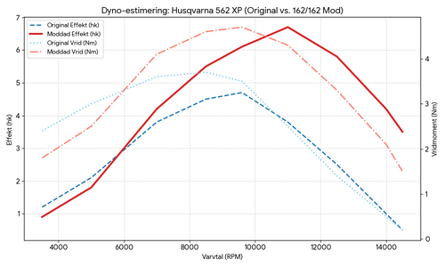

No idea about power but I uploaded a video to Google gemini and let it make a sound analysis. Based on that it also created a theoretical power curve. It is stronger and want more rpm. I have no idea how realistic it can be.
