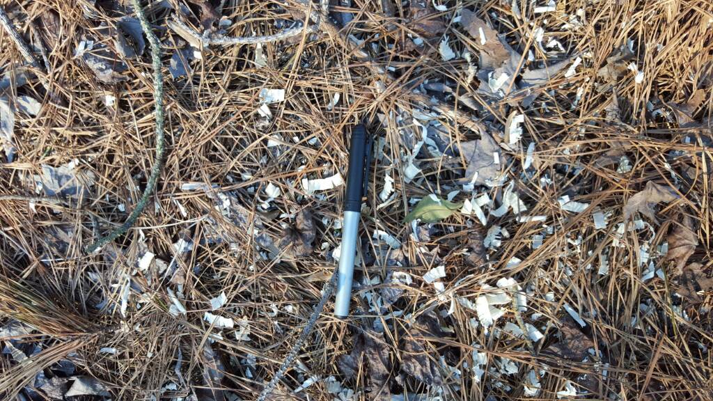

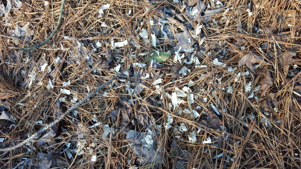

I did this experiment and put it on youtube. Poke around and you can see it in bigger pine too. No skip tooth though.

Nice videos Wolverine, clearly shows the 3/8 to be a hair faster. I've never run anything but .325 square chisel on my 346. Never felt a need to switch it out. I can see the simplicity of having 1 file size for everything, but the way I built my saw box takes that inconvenience out of the picture for me.
