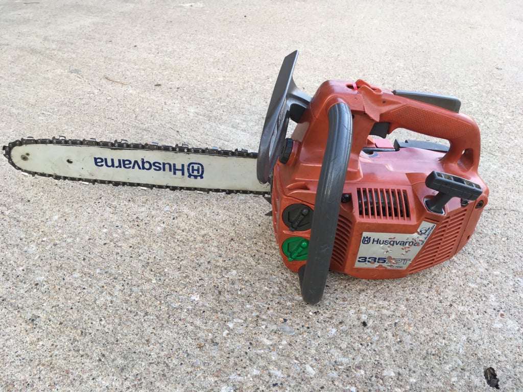

Finally got it running after screwing with it off and on for two years.
Low at 2 turns, high at 4 [emoji15].
Turned in the low just a touch for a stable idle.
Is the coil rev limited? Seems to hit a wall at not much speed.
Maybe the muffler is clogged. [emoji848]

Mine just barely 4 strokes at 2 turns out on the high, turns lots of revs, 2 3/4 turns on the low. Love my 335.

Took it to the Iowa GTG and messed with it more.
Got the carb dialed in lots better.
Actually can be a useful cutter.[emoji106]

Saw is rather unpleasant to use in a long cut without leather glove on your right hand. [emoji35]
At first I thought it was exhaust burning my hand but realized it was air off the cylinder.
It desperately needs a deflector of some sort at the gap between the housing and crankcase.

Glad you got it dialed in. My stepson has a pile of small linbwood, and i find it excllant for dealing with That kind of thing.
I never noticed the heat problem.
