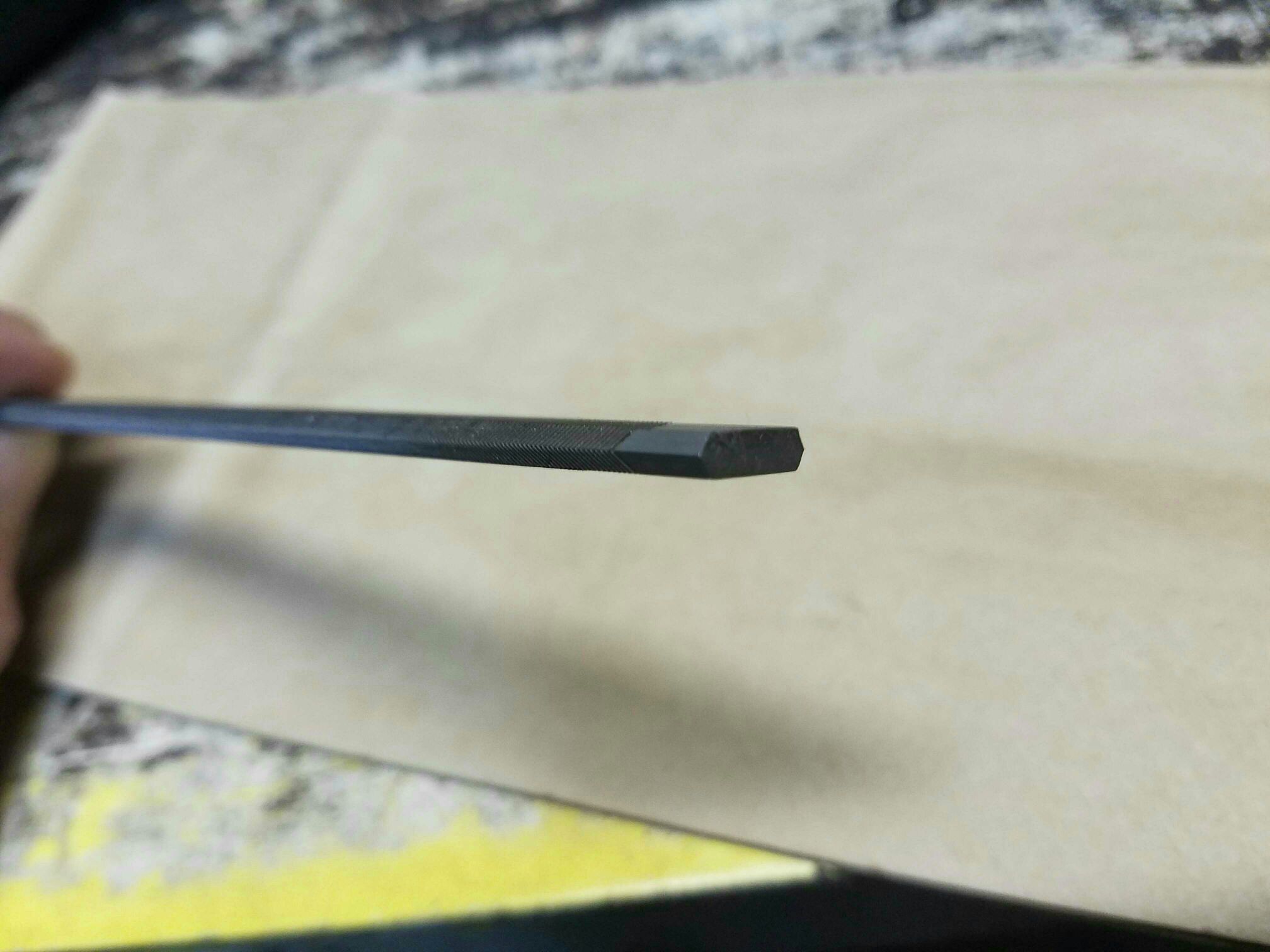

Thank you. I got that file locally fo $8 . They have the triangle files for $7.You sure get a lot of the side plate for a double bevel. Nice work though the cutters look good
I'll call him on Monday and get it for you. If he cant/ won't get them let me know and I can send you some.What's the part number for those? I'll ask my dealer if he can get me some of them
Please post it here. They quit putting the double bevel files in the dealer book and like a moron I threw away the book I had with them in there. Now all they show is the triangle files.I'll call him on Monday and get it for you. If he cant/ won't get them let me know and I can send you some.
OkPlease post it here. They quit putting the double bevel files in the dealer book and like a moron I threw away the book I had with them in there. Now all they show is the triangle files.
Are you using the wide part of the file for the top of the cutter ? Hard to see exactly but looks like using the side of the file in the corner ???First one of different chain.![]()
Such a steep angle on the underside with the top plate is doing thatAre you using the wide part of the file for the top of the cutter ? Hard to see exactly but looks like using the side of the file in the corner ???
Do I need to hold the file a little flatter then? I watched your video again and it's seems like that's what I need to do. Would it also make my top plate thinner?Such a steep angle on the underside with the top plate is doing that
It will make it a little thinner. Your cutters will be durable like they are.Do I need to hold the file a little flatter then? I watched your video again and it's seems like that's what I need to do. Would it also make my top plate thinner?
Ok. Maybe I'll make a little adjustment and see how it looks.It will make it a little thinner. Your cutters will be durable like they are.
