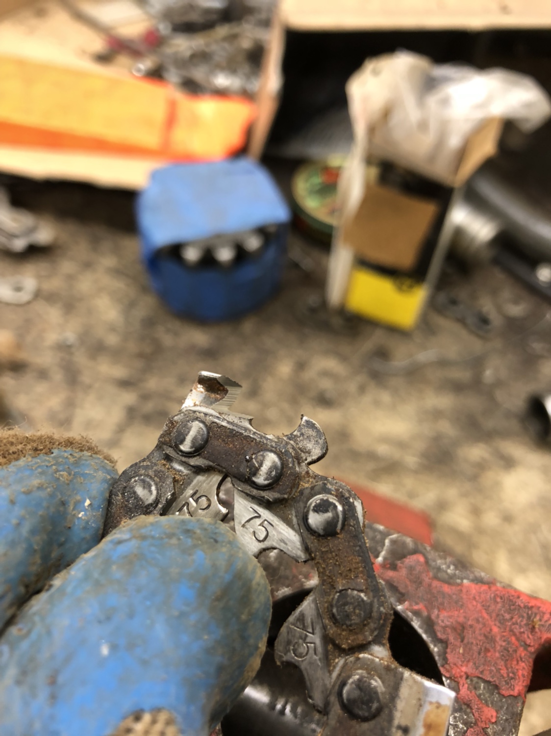

Beautiful setup you got there. Are you happy with the square chains it produces?
I was having to adjust the height after several strokes.
The double bevel is a little thinner than the 3 corner.
Many things I can't seem to do in addition to sharpening a chain - can't get a clear picture with the cell phone. Anyway, unless it is just me I think this is going to be a tooth by tooth adjustment on the height. Below are some shots of different cutters taking in sequence. As you can see the corner goes up and down. I also noticed some round corners - is the file wearing out? I used it a lot playing with the first chain - as in taking an 1/8" or more off many teeth. One thing is clear in the pictures: to go corner to corner on a Stihl chain you need close to 45 down angle. These were all filed at 30. Ron

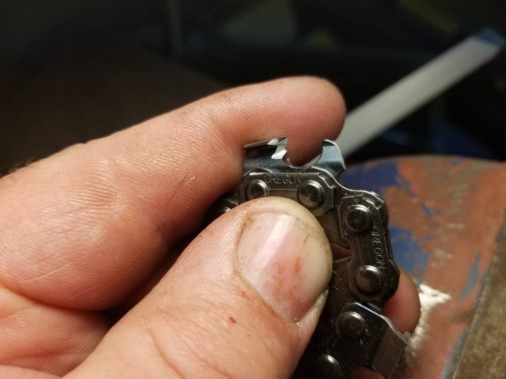

Some more pictures. Notice the round corners.
Low
Back to center.
Round and not sharp
Round and not sharp
I need to put some felt or rubber on the bottom of my base as it slides around now that I sanded and lacquered it.
Advice appreciated.
Ron

My advise: forget the corner to corner stuff. I only know that people way smarter than me say it's a nearly unobtainable and useless quest. Something white behind the tooth will help with your pix. DW

The closer you get a corner to corner cutter the stronger the cutter will be a beak like Ron has there will be sharp for a few till the beak turns over.
