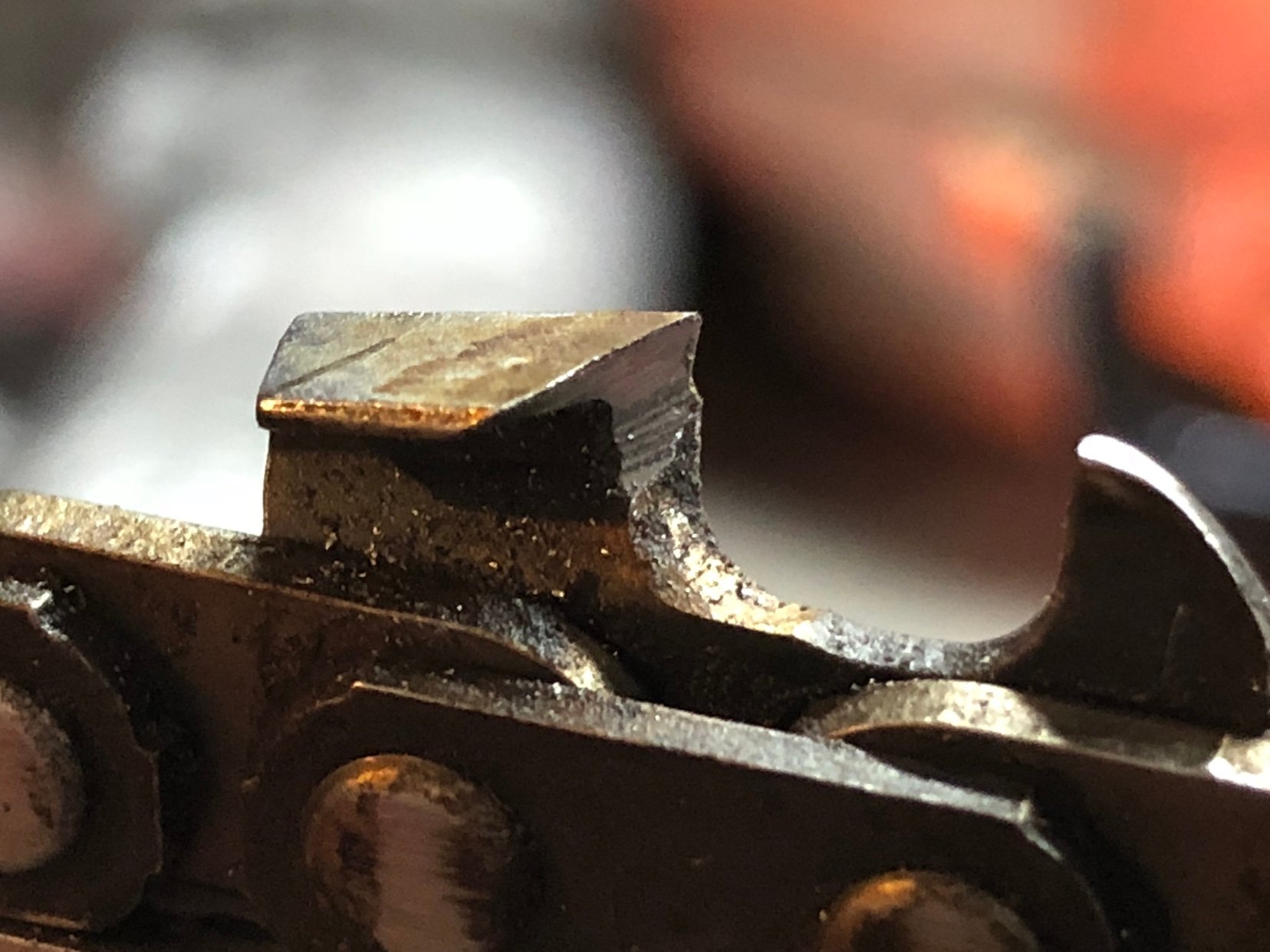

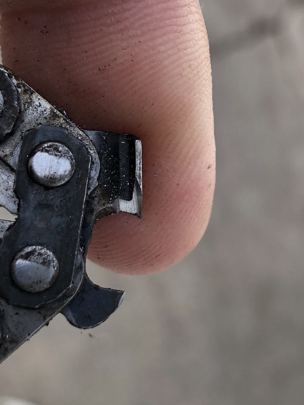

Second attempt at square. Converting some round to square. First chain looked like a butchered up hack job but didn’t cut to bad for what it looked like. Five strokes per tooth. Any advice or thoughts appreciated. I haven’t cut with this chain yet. Just finished it today.

Take the chain and hold it so you can snap a picture like below, if you can. Then we can see better

Those are some aggressive angles Aaron. Keep your guides high to start.
Clean the gullet so your not fighting the bottom edge of the file.

Are you holding the file (somewhat)like this?
