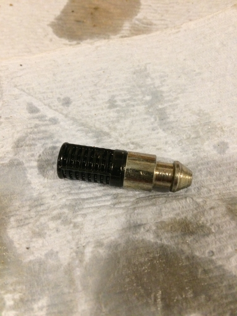

https://uploads.tapatalk-cdn.com/20170527/f40944c1337cb0fe8bed3005d37b0fcf.jpg[/IMGbeen in to this side already with a pipe cleaner and dental pick
What am i missing
Tpagel
9:53 PM
622
785
2,287
Central IL
This looks like new
