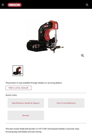

I use a Magna-Matic Mag 8000 blade sharpener. I wish I had known to wait for the Mag 8200B belt grinder.
I do some sharpening in my shop.
The only thing I buy from Magnamatic is their blade balancer, which is excellent. I spent many hours sharpening on an old Magnamatic stone grinder on a stand, starting when I was so young I had to stand on a 5 gallon bucket to reach it (I’m 6’ so that was when I was about 12 years old). That really soured me on a stone grinder, and also on their reverse rotation, which does eliminate a bur, but it also requires much more pressure on the blade, and the sparks blow in your face if outside in the wind. Oregon’s modified Burr King is the runaway leader currently. It has paid for itself way faster than any other costly tool we’ve ever bought. Of course we got it at dealer cost in 2015, so it was 2k and some change.IMG_0939.jpeg
