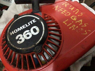

IMG_8167.jpegHey folks, what do y’all recommended I use to remove the paint or permanent marker off this recoil? PO did it. Doesn’t need to be perfect.

It depends some on what the paint is. Isopropyl alcohol works on much of it. If that doesn't work, maybe acetone or paint thinner. With the more aggressive cleaners, experiment on a spot to make sure it doesn't also take the original paint off.

If it is a sharpie marker, go over it with a dry erase marker, that will break down the sharpie and allow you to wipe it off. May take a couple of passes. Worked great for me.
