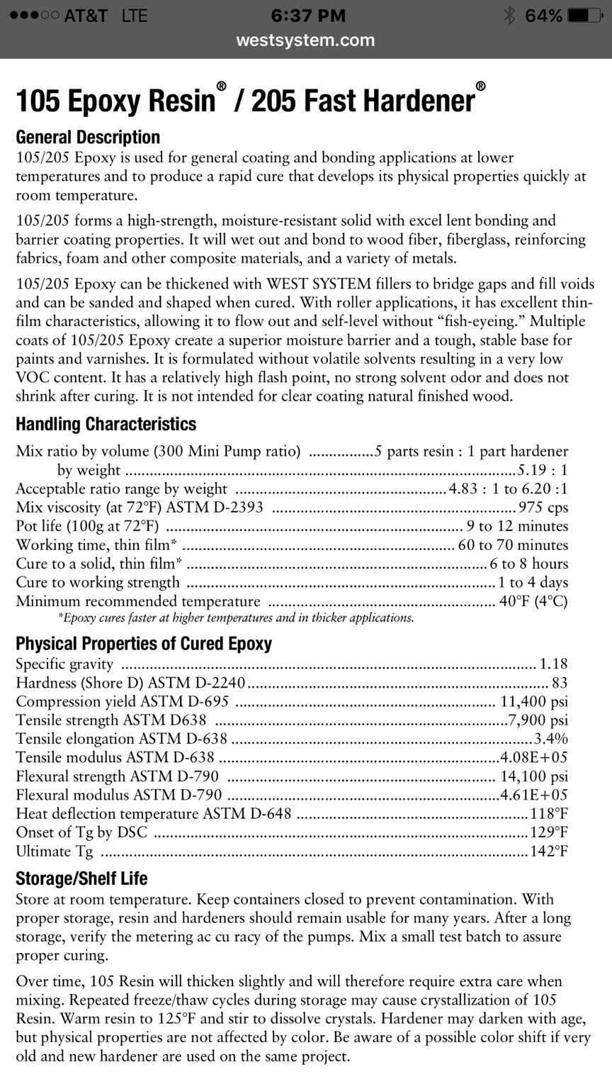

You'd be better off using west systems 2 part epoxy. It's for boats but I use it in woodworking for filling voids and knots in live edge tables etc. I think this would be the easiest solution to fill the bars.
http://www.westsystem.com/ss/?redirect=false
This is what I was going to suggest. ButIi was also wondering if it would be too brittle. That being said, I've used a ton of this stuff on boats and never had it crack. Also use it to finish fiberglass columns on commercial buildings. It's pretty good stuff.

I have thought about this, but would be curious to read some specs on temp, and oil resistance.

I have some plastic sheeting I'm going to use. It's almost the thickness of a bar. I've worked a lot with epoxies and while I'm sure west system has something for this.... I wouldn't spend the $$$. Plastics should be ideal if we can find a good way to mate the two.

So once I get a few of these cut, I'll probably try a few different approaches for filler. @Philbet has me intrigued with the idea of recyclying HDPE, and using multiple "posts" as a mechanical fastener, and I appreciate all the info provided on the Marine Grade epoxy resin(probably another option I'll try. The Devcon product holds promise, because of the ease of application, and after a little more research, it is very light by comparison to steel (2.33sg vs. 7.8sg).
