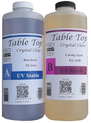

This might be foolish but what about this epoxy bar top stuff? Seems to hold up well on bar tops and people abuse those.
Epoxy Table Top Resin, 1:1, 2 Quart Kit, Crystal Clear, Parts A & B Included
  • 100% Solids, High Gloss, U.V. Resistant, Excellent Air Release, & Color Stability
  • Improved Impact Strength, and Surface Appearance
  • Produces a Tough, High Gloss, Water Resistant Coating
  • Gel-Time 100 Gr. Mass @ 77F, Approx. 25 Min, Full cure 48 Hours, Hardness 70-75 Shore D

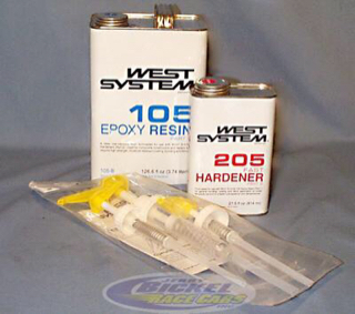

You'd be better off using west systems 2 part epoxy. It's for boats but I use it in woodworking for filling voids and knots in live edge tables etc. I think this would be the easiest solution to fill the bars.
http://www.westsystem.com/ss/?redirect=false
