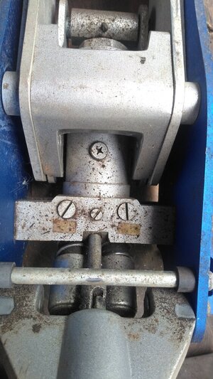

Look at the cylinder and there should be one on the top. Don’t open the two next to each other. Can you post a picture of the jack in front of the handle
Here's a pic.
Sure would like to know how to geet it to stop leaking off...........

Here's a pic.
The one with the Phillip head is the fill. Add some atf if you are going to try to fix it instead of return it.
