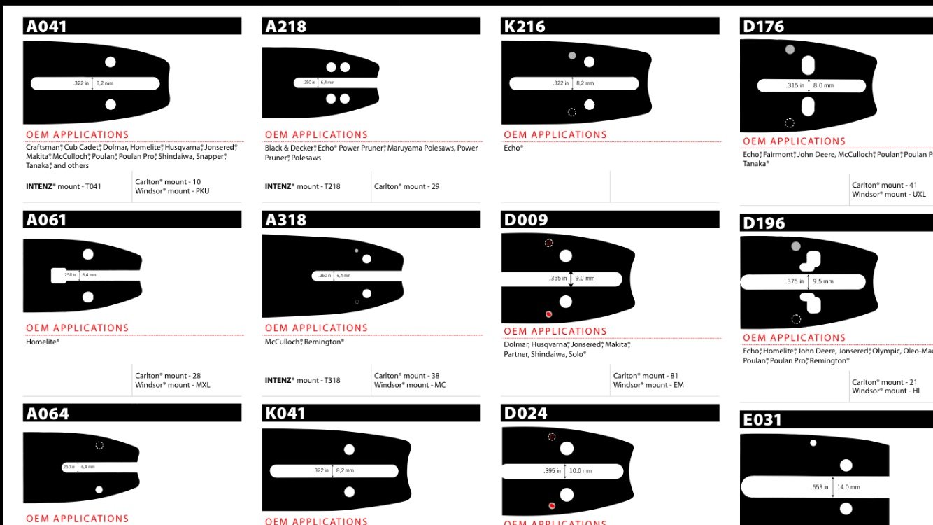

The tail on the bar of the A041 is smaller. Look at the first one 1st row and the 2nd one in the 3rd row.
I was looking at the pictures closely but not close enough- thank you!

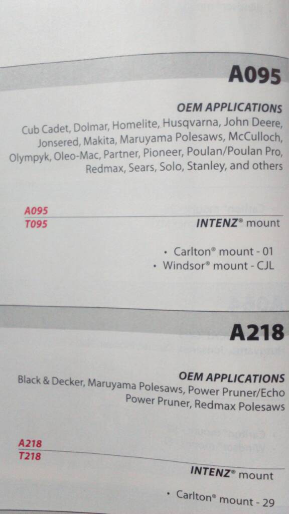

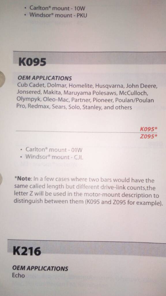

Chris,
Do you have the next set that show the differences between a K095 and an A095?

Chris,
No i don't Jon, i just opened the link Mycamero posted. I would assume the difference is the A tail is smaller on the 095 bars also.
