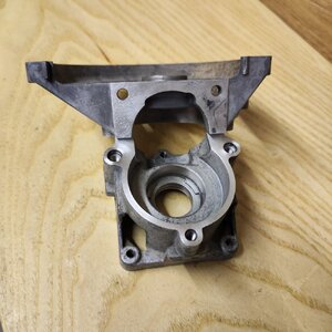

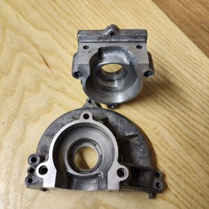

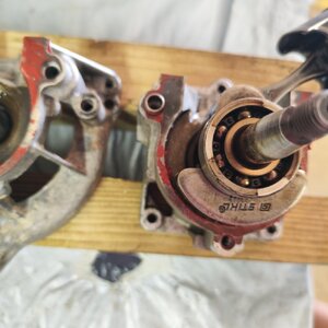

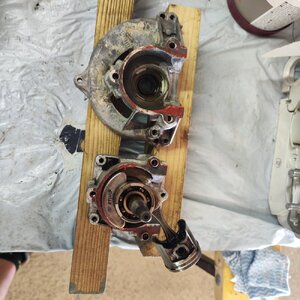

Hi all, just to round off this thread - splitting the case actually went pretty well. I put on some massive welding gloves and heated the case up gently with a gas torch and then gave it a gently love nudge with the softest hammer i have and it popped straight away. Attached should be a few pics. I cleaned the whole thing up and ground each case half on some float glass with 320 wet and dry. To get it back together i did the reverse and heated up one side, dropped in the crank with bearing in place already, then waited til it cooled to apply the liquid gasket to that side - I went with the black Visbella - then heated the other side and dropped it on. Once tested it was perfectly air-tight...still can't get it to run without the choke on a bit but haven't really played with the carb yet and always thought that was the worst underlying problem. Still, good to get the case sorted - everything thing else is external now.
