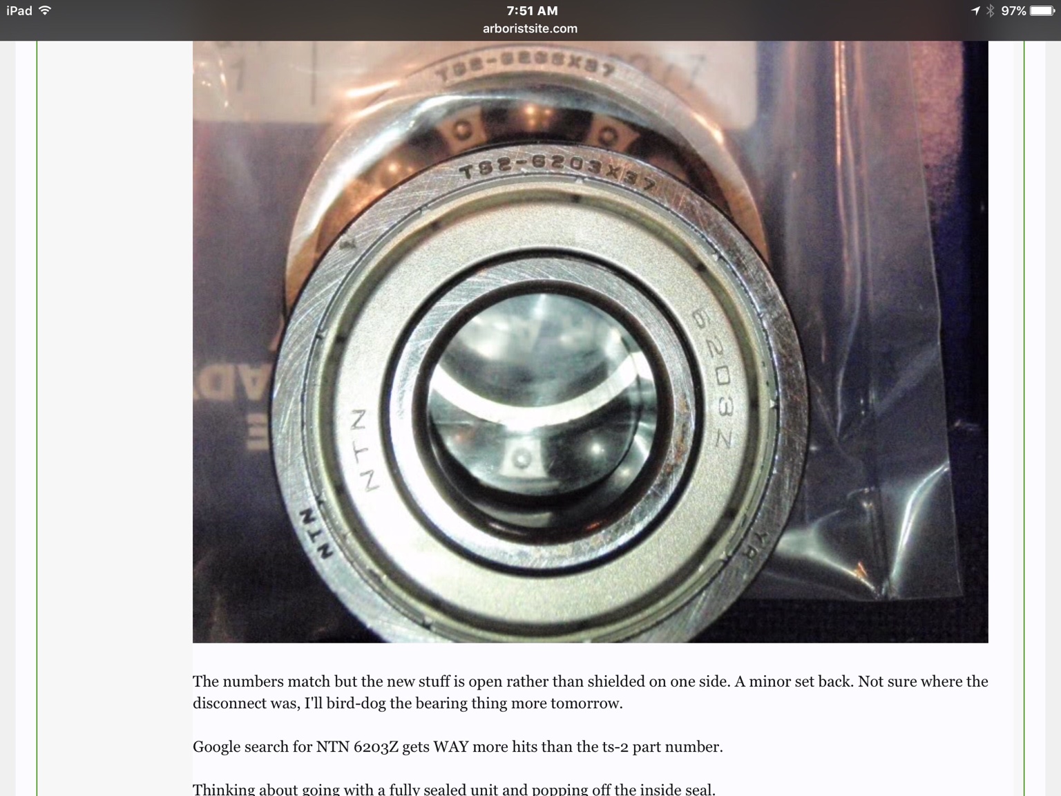

I wonder if the bearings had side plates to the inside and not letting the tranny fluid to get to the seals
Did all the bearings open ?

Hmmm I can check. You are talking about the plastic shield that comes on some Stihl bearings right?

Wow I never realized or saw metal shields, I will definitely look at all the cc I tested

the early 066 has a metal shield on the PTO side bearing, that probably invalidates the measurement on that model, all the others were shieldless

the 044 i stripped on friday had metal shielded bearings. i thought maybe someone had changed the bearings and left them on. surprised the factory was leaving them on. with shields on the mix wont get in to lube and cool the bearings.

If you have measurements of bearings od, I'd and width you can many other good options shielded, dual seal, non shielded, hybrid ceramic, and the very costly full ceramic that can run lubed or dry
The shields are mainly dust covers they will get lubed. sealed bearings are shielded with a seal molded to the shield and those won't se much lube from mix even with the vacuum and case pressure.
IPL says "grooved ball bearing" 12 x 40 x 14( Fwheel) 6203
and the proprietary 17 x 40 x 14( clutch) one I removed from clutch side says NTN 2TS2-3A-SX0393 ( proprietary)
