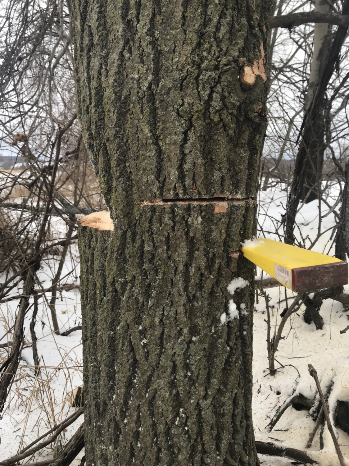

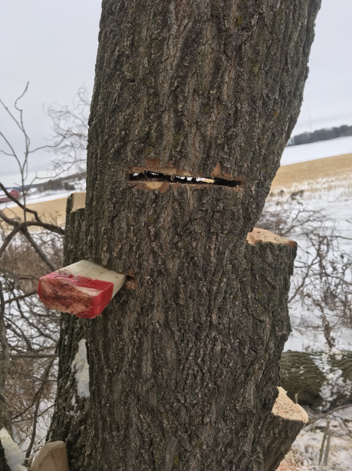

Here is what I was trying to describe earlier. The wedge is never in danger of the saw and it doesn’t bottom out on the hinge.
The back strap was too thin and I lost some lift when the saw kerf from the plunge cut closed.
Too much back lean and the cut for the wedge was too low. The wood didn’t separated like it’s supposed to.
Sent from my iPhone using Tapatalk[/IMG]

I just started using it so, as you can see I’m still learning the fine details. I do like the fact that I’m walking away with an axe in my hand and not a running chainsaw.

When placing the wedges in the same as the plunge cut you can get some sideways push and the saw can clip the wedges when cutting the back strap.
