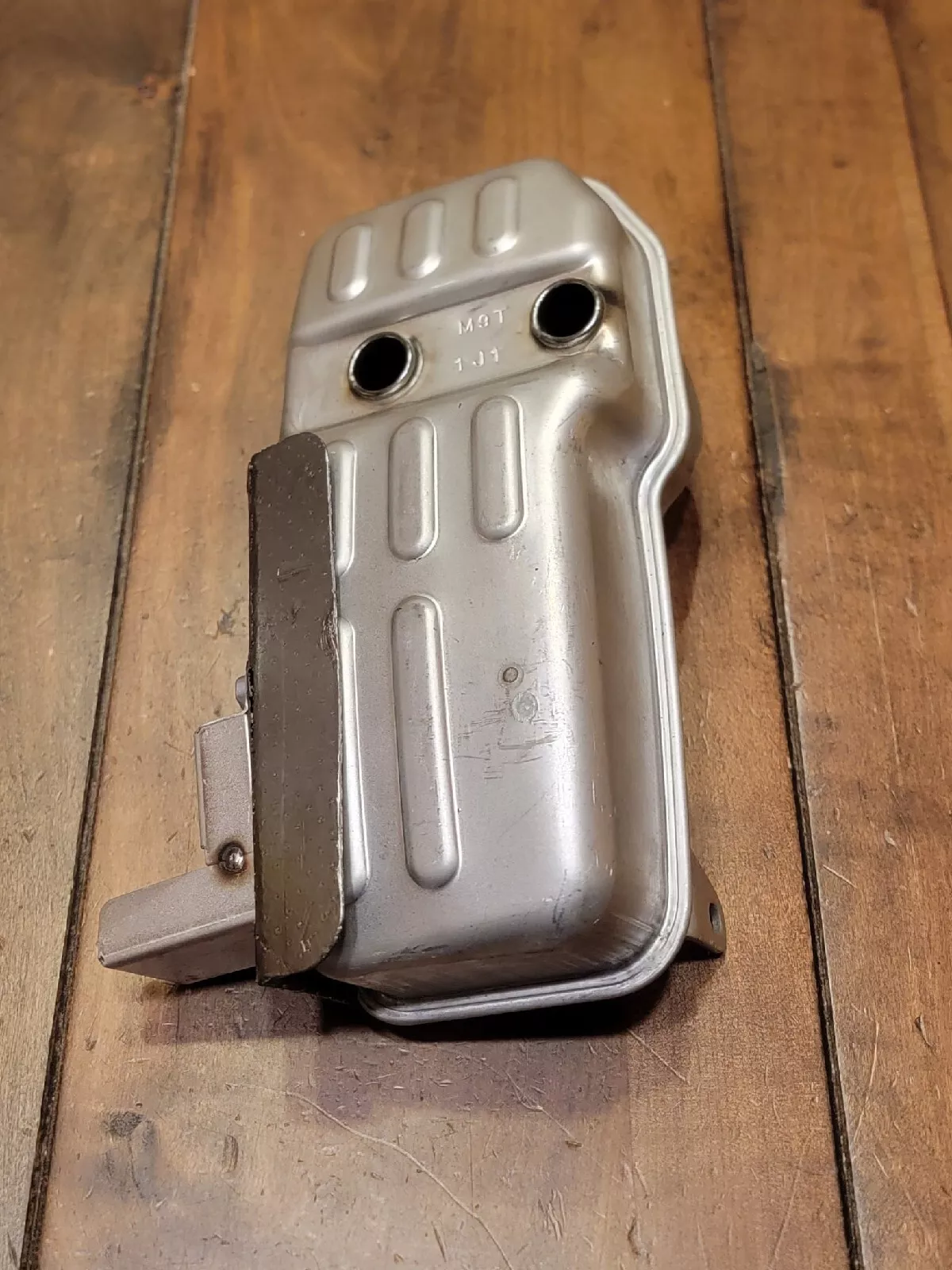

The one Echo blower I worked on had a tall, skinny muff with a cat that killed it with very few hours of run time, it dumped so much heat and crap back in the cylinder it ruined the plating.
Stolen pic of a similar muffler, I drilled one corner right where the seam starts to "bubble", picked at a side until it lifted, then used a small flathead and a hammer to work the rest of the seam apart. I cut the inner baffle off right above the cat, leaving a ~4" plate down the middle of the muffler for noise reduction. I also opened up the muffler under the factory outlet before crimping it all back up and calling it good. That was ~2 years ago at least and to the best of my knowledge it's still running good.

a tall, skinny muff with a cat that killed it with very few hours of run time, it dumped so much heat and back in the cylinder it ruined the plating.
Not to be anal, but I would blame this more on running lean than the cat, although the cat probably added enough heat to make the difference between just running lean and actually scoring. The cats are a double edged blade--a lean, hot running engine produces less unburned fuel to get burned by the cat, but an engine that is set rich can actually destroy the cat over time and produces a lot of unnecessary heat from it burning so much fuel. I've seen various cats come loose in the Echo blower mufflers, and Echo blames it on them getting torching hot from running rich. So yes, taking them out is DEFINITELY the way to go.
