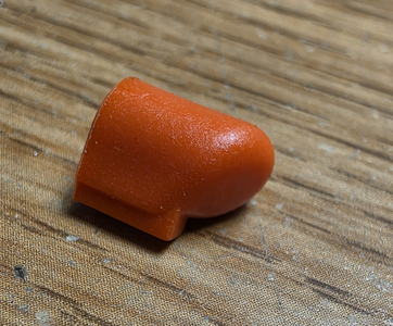

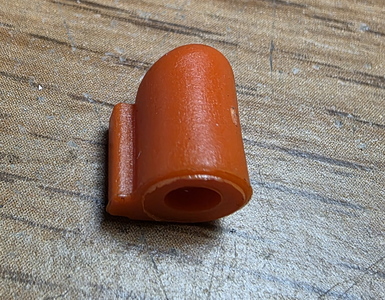

OK, next question. What the heck is this for? It was in the bag with the scrench and T27 wrench. The hole looks to have some markings resembling threads, like it's supposed to be screwed into something.
EFSM
8:59 AM
29079
Apr 30, 2024
1,161
2,778
Extreme southern IL
There is supposed to be a different sized palm rest for the top handle in the bag, but that’s not it.
JRHAWK9
8:59 AM
931
Feb 23, 2016
65
184
Lake Delton, WI
Now that I look at it more. It may be a "plug" in case one doesn't want to use either one of those palm rests.
JRHAWK9
8:59 AM
931
Feb 23, 2016
65
184
Lake Delton, WI
I just looked. That's exactly what it's for. I removed the palm rest and that little piece fills the hole and uses the same screw to hold it in place.
Mystery solved. LOL

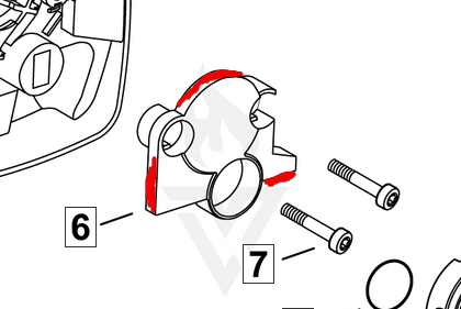

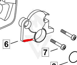

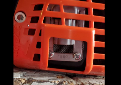

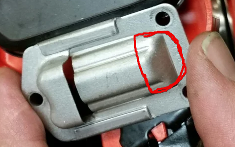

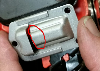

What do you mean by “opening up the intake”? Enlarging the holes in the cover?
JRHAWK9
8:59 AM
931
Feb 23, 2016
65
184
Lake Delton, WI
Yep and also removing some of the material in that "splash guard" that restricts air flow. I was going to remove it all together, but I think I know why it's there, so I just took out some of the ridges to make it flow better.
I removed the ridges in these areas.
