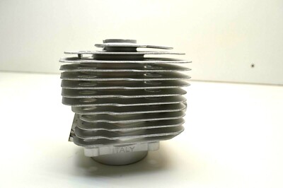

There are these for 2100 - RMC brand out of Italy. I know nothing about them.
I've got one of these in the box waiting for a donor carcass - quality is great in appearance. Haven't ground on it at all to see how the plating reacts, but looks really good.
I went ahead and ordered one last night so I'll be able to report on it too when it comes in. I'll be grinding on mine after I get some saws done for some members here and start working on my own stuff.
