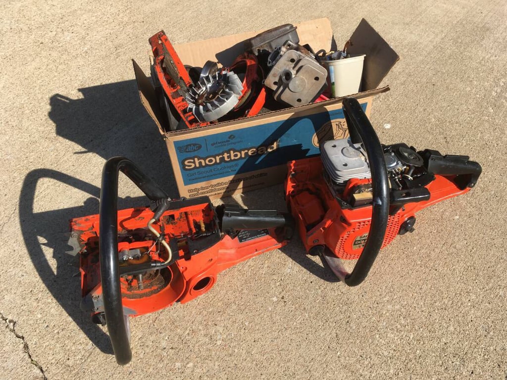

Hi all. Looking for opinions on what to do with a Sachs/Dolmar 111.
The guy I got it from said it ran good until the recoil broke. He stripped out all the recoil parts from the housing, so a new, complete one would need to be obtained.
The clutch cover appears to have been gnawed on by some type of angry beaver, the handle has been epoxied, the handguard is missing, and the attachment point has been broken off the crankcase. All brake parts have been removed.
Compression feels fair based off rotating the flywheel, but without the recoil, I cannot obtain an actual number. Piston and cylinder look pretty good with muffler removed.
Dolmar is not popular in my area, and this is the first I have put hands on. Dealer support is virtually zero, nearest dealer is 100 miles away.
So, is it worth spending the $60 or so to obtain a recoil, or just simply part it out?

Wilhelm, Get a parts saw and combine.

I save a couple of parts saws that I simply could not fix for things just like this. Examples include saws run over by pickup trucks or dropped from trees, 60 feet up. Using them, I have saved several others that needed new or used parts to keep going. If this saw looks like it will eventually run (good compression, etc.), it's likely worth trying to save first. Only if it's simply impossible, part it out.
Incidentally, two of the best saws I have are Makita/Dolmar.

Thanks for the input guys.
Based off that, I guess it is worth me investing in ordering a new recoil assembly and seeing where it goes from there.
I would be leery of allowing it's use by anyone other than myself due to the lack of handguard and chainbrake, so I guess it could be a backup to my backup if it turns out to be a runner. I wouldn't likely sell it as a running saw for the same reason.
Simply keeping it for parts was a thought, but I see so few Dolmar's around here, finding a use for it in that aspect would likely be slim, although possible.
Being that they are scarce, I didn't know a thing about Dolmar, other than what I have read on the internet prior to obtaining this thing.

Here's a clutch side pic.
First thing is to get the recoil to see if it even runs. I have not had time to vac/press test it either.
Like I said, it looks like something gnawed on it!
