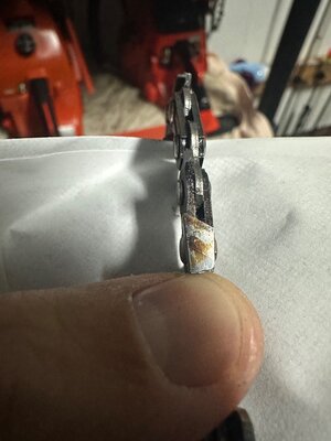

I was looking over a chain last night and I noticed some of my teeth have a bulge in the leading edge. See the sketch below. I will also take photos of the chain.
What causes this in a sharpening stroke? Trying to understand what I am doing to lose the straightness of the tooth edgeIMG_1551.jpeg

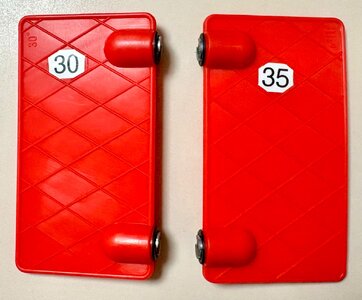

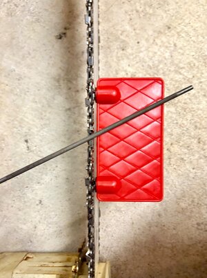

Or it could be that you're rotating your body during the file stroke, instead of pushing straight through with just your arms. Sometimes it's tough to isolate the arm motion to just a push that is both straight (on a 30-degree or whatever angle you choose) and also flat relative to the top flat plane of the tooth. If you have a shop vise that helps a lot, especially if you can get in a position to rest your upper body against the vise or bench to keep it in a consistent position, and pull each tooth into the same position on the bar before you start filing.
I think a filing guide helps establish a straight motion, as you can easily tell visually when your file angle starts to get off. I like this one because it's simple and a clear visual reference yet it doesn't require any clamping of the file or extra hardware, but I'm sure there are others:

I spent some time cleaning up my previous sharpening chain this weekend. I took my time and got my body in a different angle to better see the angle.
I also put my hand underneath the golf ball which helped prevent the tilting issue I was having. All in all I was happy with the results
Thanks you for all the posts with advice
