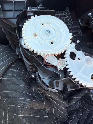

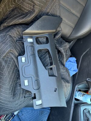

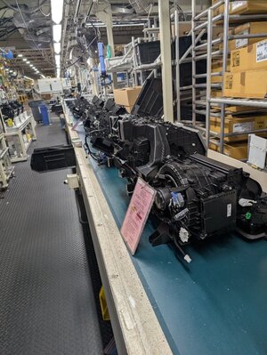

Glad you got it back together. For folks that aren't in manufacturing, the tabs and holes circled are spots where tooling fingers on a robot grab these parts to assemble them. The crv is all hand assembled here. I was in on the first automated HVAC assembly line in my plant about 15 years ago. Honestly, not much has progressed in our building since then. Even the auto lines still have manual assembly elements as well.IMG_2938~2.jpeg
