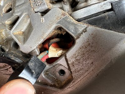

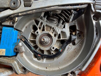

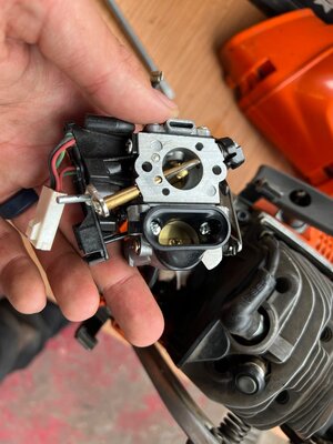

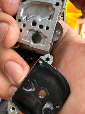

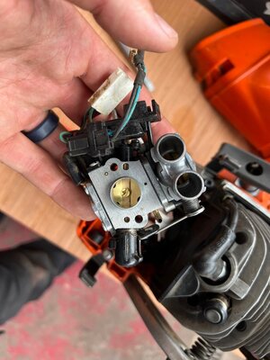

Apologies for the delay in reply lads I was running a course this week and my mind was elsewhere, I stripped the 560 down last Friday to getting it working for this course.
Here’s what I found… nothing of note :facepalm:
Cable under the Flywheel looked as good as new, as did all the cables and connectors heading to the carb and plug.
The carb itself looks brand new, not a spec in the screen, diaphragms were perfect and everything looks as clean as a whistle, no build up whatsoever.
