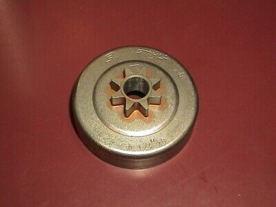

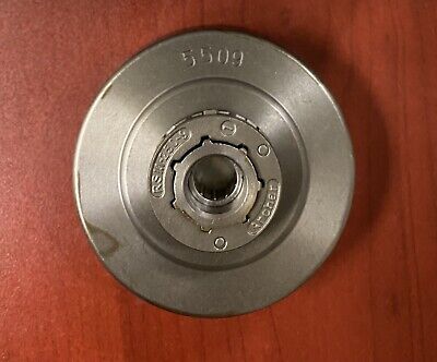

It has the original 1/4" sprocket, when I get to it I'll post pictures, in a 400 now.
Archer, with rim sprocket..
Li'l Red Barn has the same, cheaper
Oem, spur

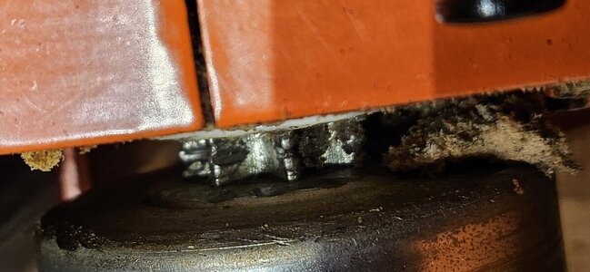

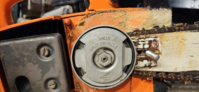

How do I best hold the clutch to loosen the bolt?
I  think it's possibly the original sprocket (slightly worn).
Pull the plug out and use a piston stop. If you don't have one, some old recoil rope pushed down the spark plug hole will do the trick. Make sure the piston is above all the ports before using this method. You don't want the rope caught in any of the ports.
Thank you for the advice. I don't have a piston stop, though did get the clutch spun off and rim sprocket replacement ordered.

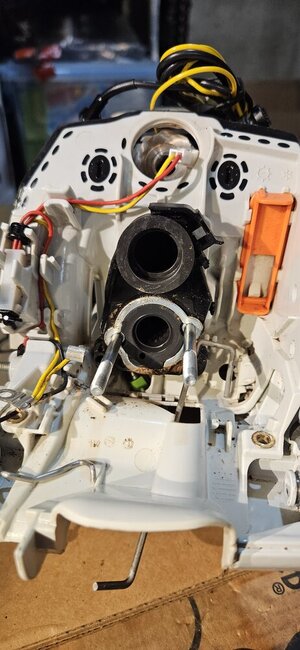

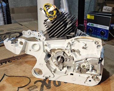

Going to share details, how you got inside it?
That's how to get tiny parts out, push 'em from the inside! (I just eat something that doesn't agree with me, 20 minutes later feels like i dropped 25#)
Didn't have a tapered manifold plug big enough for the top port of the MS400 intake boot (couldn't seal up during vacuum test, and even less so during pressure test) so removed the intake boot and am going to cut a block-off plate tonight and 3mm silicone rubber gasket. Exhaust is sealed with the usual 3mm silicone triangle-wedge held by bolting on the muffler; the decomp. valve is removed and a tapered manifold plug inserted since they can leak when they get carbon fouled.
Chain tension mechanism is back in... 🤣

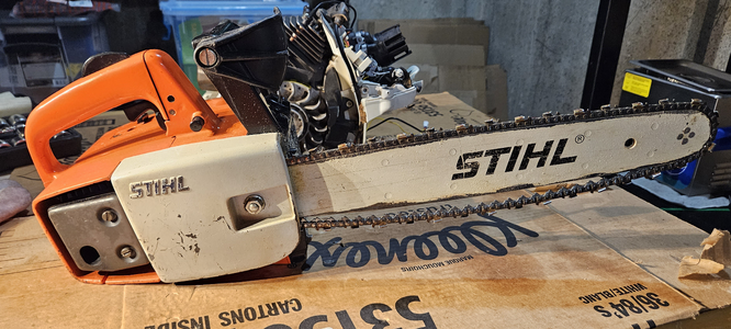

Is this that 400c you bought out of the trading post here?
WI_Hedgehog
7:20 PM
27428
Sep 8, 2023
365
957
Milwaukee, Wisconsin, U.S.A.
Yup. And in excellent condition, and clean. (seller: @jk14 )
With that said, it was a truck saw, so it got bumped occasionally, though less than normal. It also had oil-storing wood chips in fairly inaccessible crevices, enough to prevent any and all sorts of corrosion. And the multi-function lever and chain tensioner had the normal work saw type binding most people are used to.
Given the saw was in such great shape it was a candidate for restoring to "used 3 hours" condition. Most of the bumps are now gone and stuff looks new again. I hope to have a coat of wax on it by this weekend.
