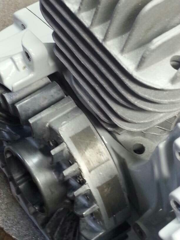

I can do a test with my hybrid flywheel on my 044. They both started with the same flywheel but I had the hybrid machined.

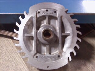

My buddy is a machinist and put it on a lathe and put a beveled edge on the back of the flywheel. On the hybrid you have to remove material from the flywheel or the cylinder or both. I opted for the flywheel and then just a little off the transfer area. I'll post a picture later.

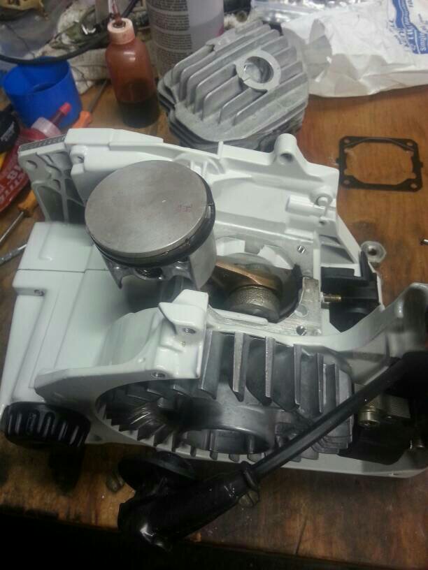

This last pic isn't mine it was posted in the hybrid thread on Another Site.
