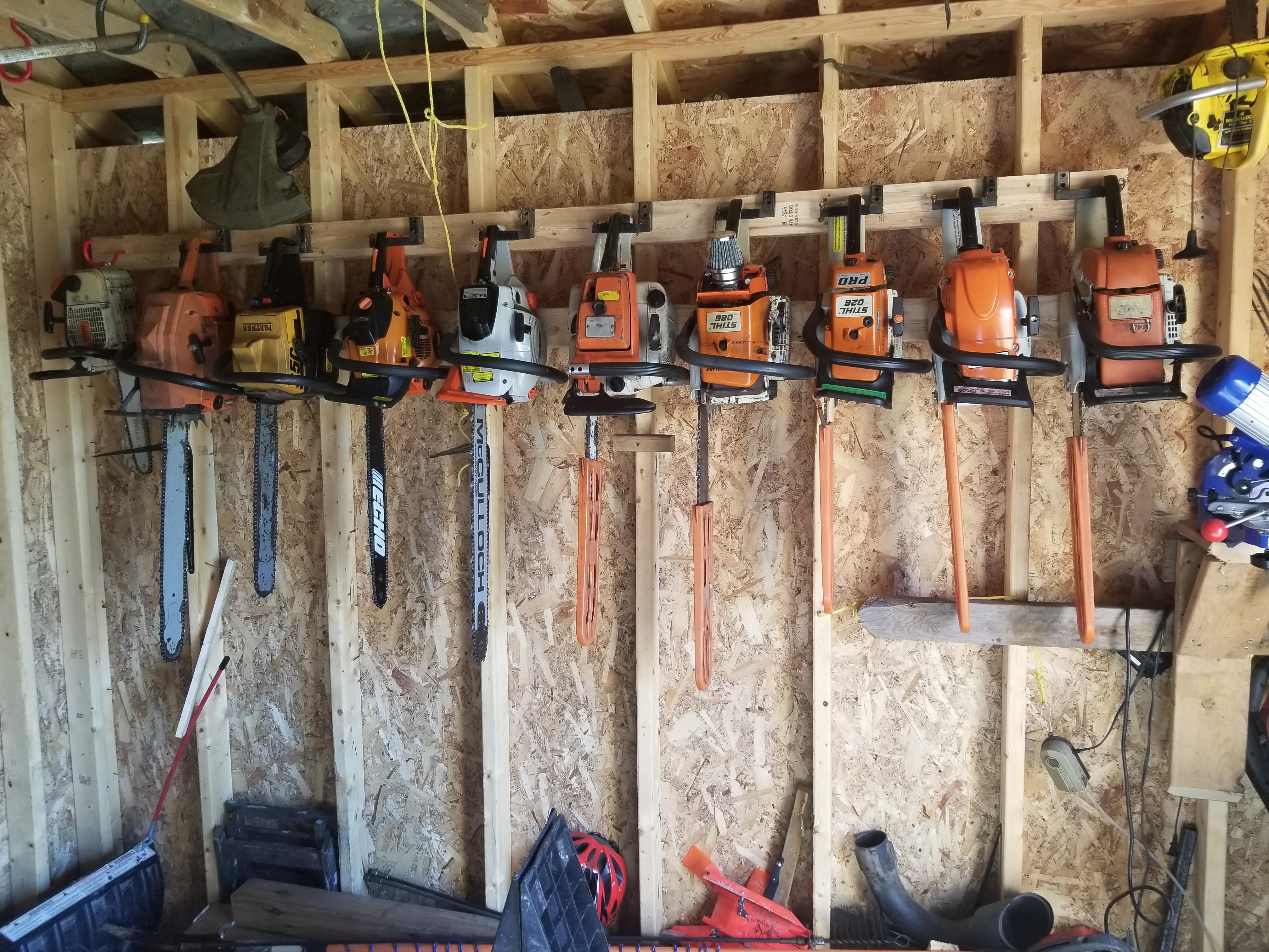

I hang them from the handles dry and barless. The ones with bars get hung from the brake handle, theyre dry too1844E649-586F-4D95-BD0C-AF0BF7B61905.jpeg
11:59 PM
14,999
59,849
I hang them from the handles dry and barless. The ones with bars get hung from the brake handle, theyre dry tooView attachment 289759
I'd be concerned about material fatigue hanging my saws on their brake handles, it's just plastic and not too much of it at all. o_O

I understand that some of the Italian chainsaws are salted before they are hung, in a cool, dry, dark, environment, for 2 years or more . . .
Philbert
11:59 PM
14,999
59,849
Same here. ‘Brake’ handle or ‘top’ / ‘front’ handle?
Philbert
They are hanging off their brake flag, it can be seen on the far left saw in his picture.
I'd be weary storing my saws like that.
Been hanging for a while now ........ haven’t had any problems
No objections, if it works for You then it's fine by me.
11:59 PM
14,999
59,849
Looks like you have . . . a few!
Philbert
A couple aren't on those shelves , all hush-hush and stuff! :rolleyes:
Those are my dedicated work saws.
I am missing a PS-420/421, not a priority getting one though - SD105 & SD108 are filling that cc slot. :)

Heres my saw rack full. I dont see how this would hurt the av mounts. Be far more damage/ wear to the av system when people are cutting with the saws.
BangBang77
4:59 PM
6487
Jun 21, 2018
438
1,844
Oklahoma
The spring AV will be fine. Contrary to what people say, there's no such thing as "spring set", i.e. they don't wear out from constant compression or constant expansion. They wear out from repeated compression and expansion cycles.
The polymer based AV may be affected as some polymers can take "set" if forced out of shape for extended periods. But repeated movement along all axis will degrade it much faster.
The rubber based AV should be fine as well. Same as the polymers.
I wouldn't worry about hanging them like that. Not a bit.
