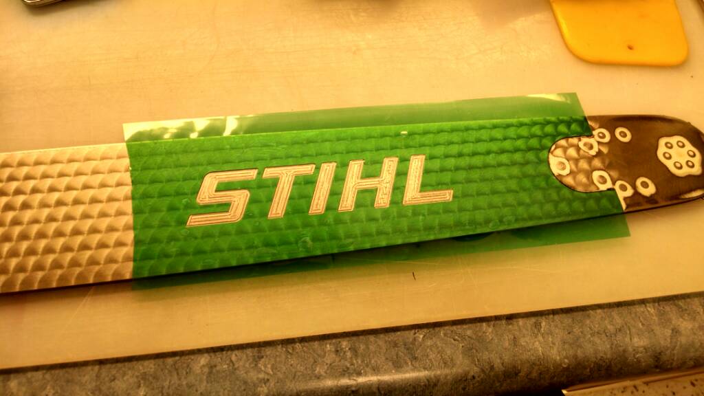

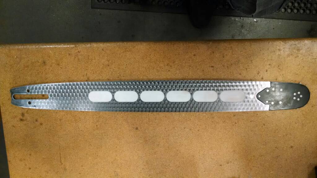

What is the stenciling gel tape called and where do you source it?
Thanks,
Scott
That particular stuff is drop from out mylar cutting machine that we use to make CNC masking for painting. We have some in a roll as shown here,
that we get from McMaster Carr and can get you the part number Monday. In simple terms its mylar tape and its billy badass! You can blast it, engine turn over it, and bake it and it will stick great and come off cleanly!

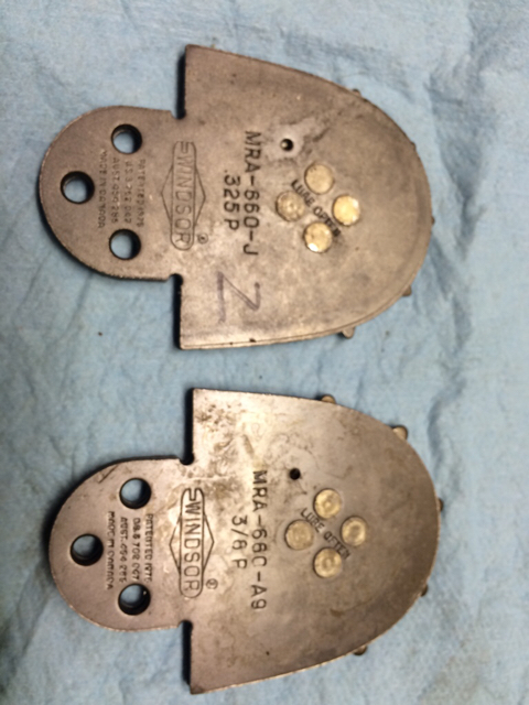

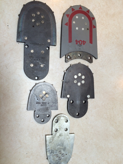

I made an evilbay snag of 31 assorted bar tips (mostly Windsor) and have about 20-25 left. The vultures at the GTG carried away some.
Lots of small ones in .325" & 3/8" LP.
With rivits.
3/8" lp: details.
.404" Sushi?
