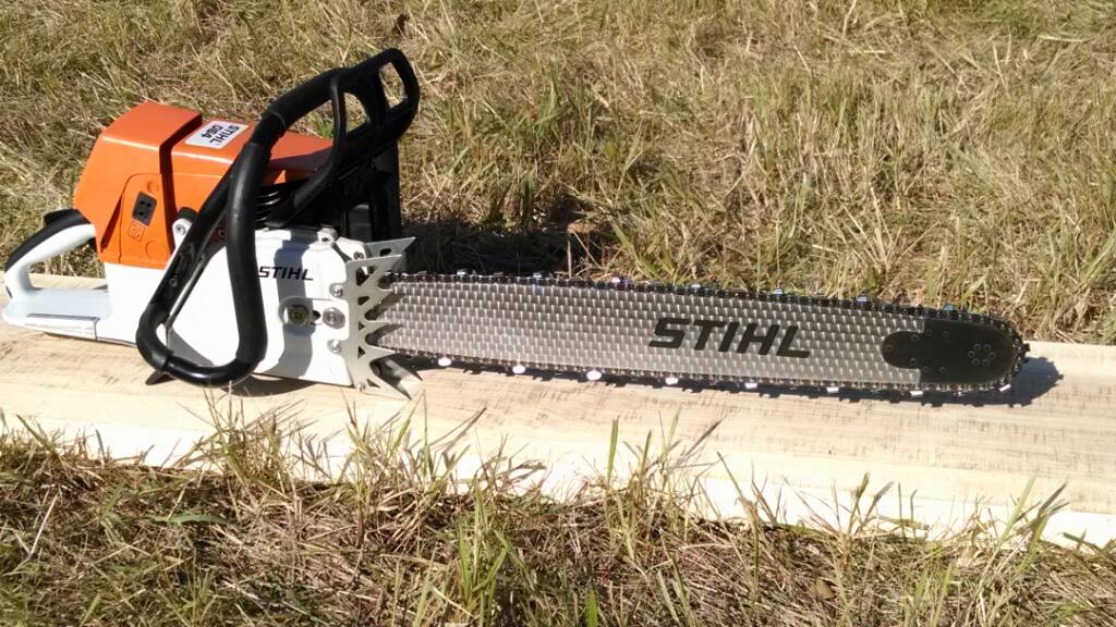

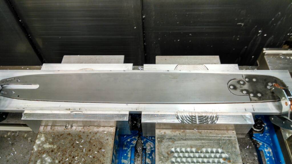

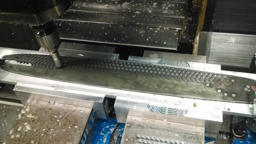

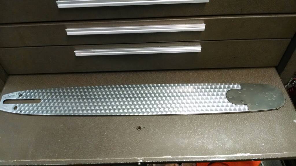

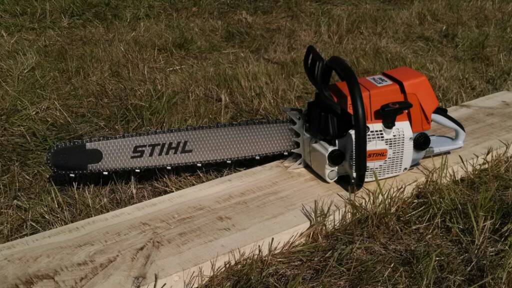

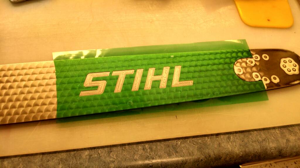

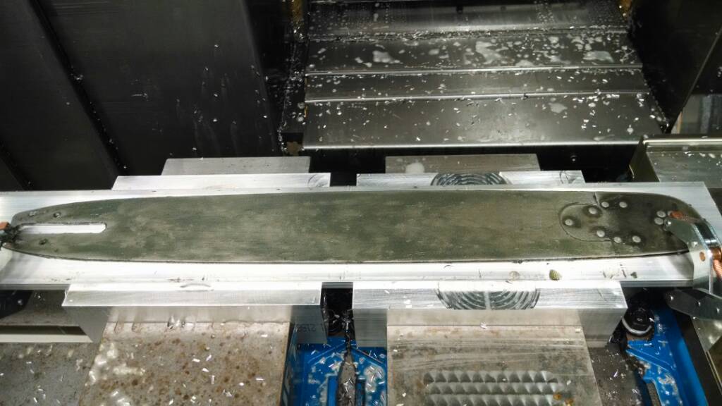

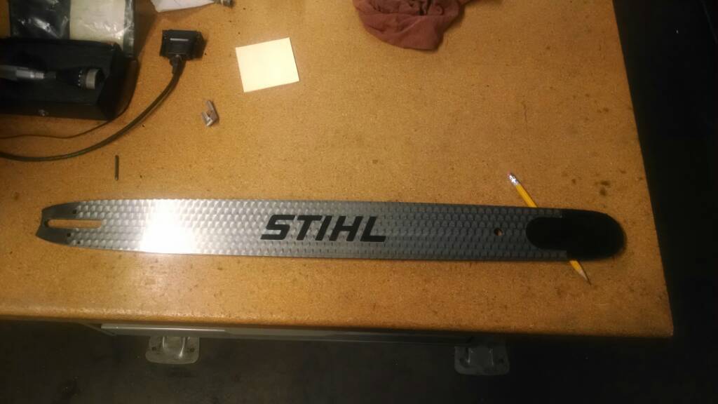

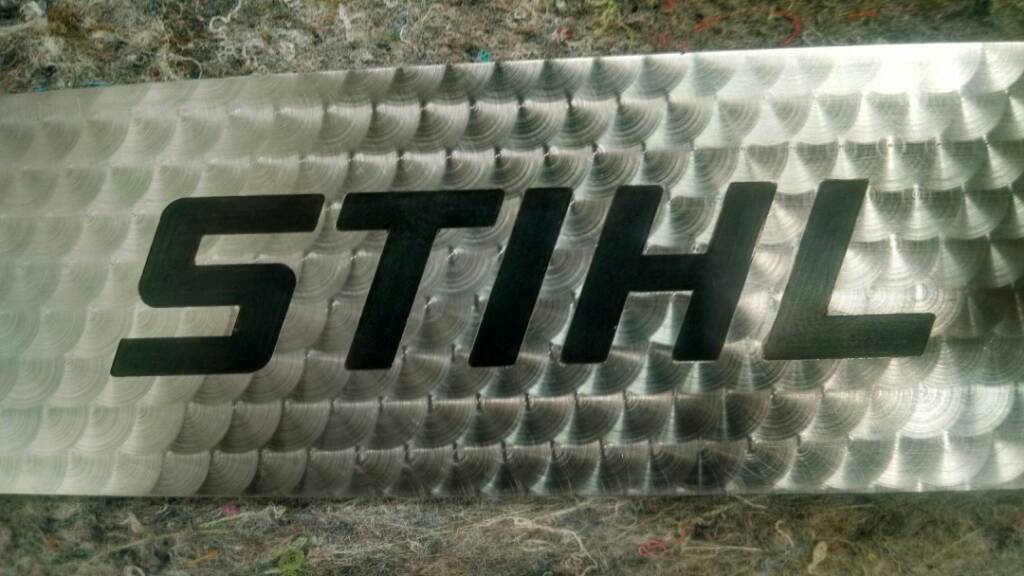

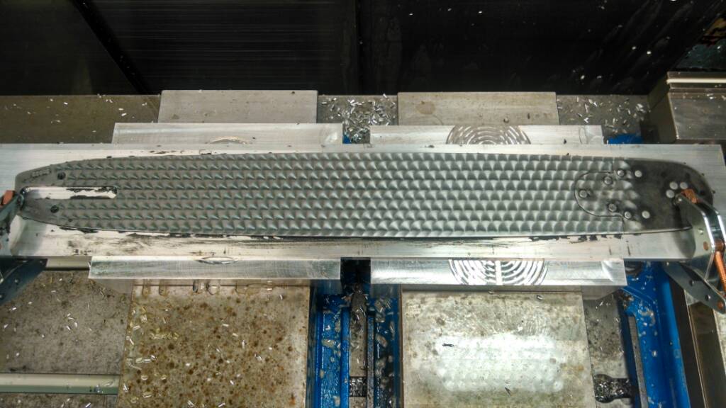

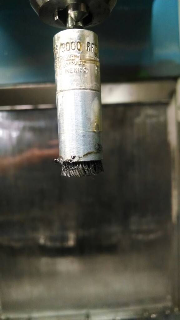

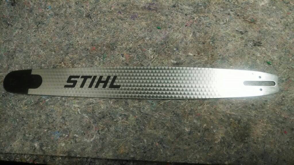

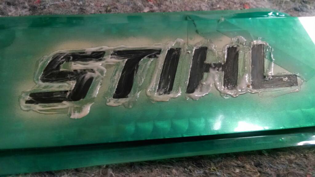

Late to the party..... I use a belt sander to get the brushed look then use a bridled abrasive brush in a CNC to engine turn the bar then pocket mill the logo. Once I'm done, I mask, blast, and cold blue the tip and letters.

The logo is .015 deep milled with a .093" endmill. The whole process usually takes 4 hours from stock bar to what you see on the saw. Stihl is the only logo I have drawn as three of these bars were gifts.
I have just gotten a sugi hara rw 24" that I will engine turn and mask off the plastic inserts. I hope it turns out good.
Nice Engine Turning, that's an art you don't see much of anymore.

Homelite, that is fantastic!
I looked at my Oregon bar after I had sanded it back and thought to myself that if would look great if it was jeweled like a rifle bolt.
Your bar proves it does!
Problem is, If I made mine look that nice I wouldn't want to use it.

That looks awesome great detail to the bar

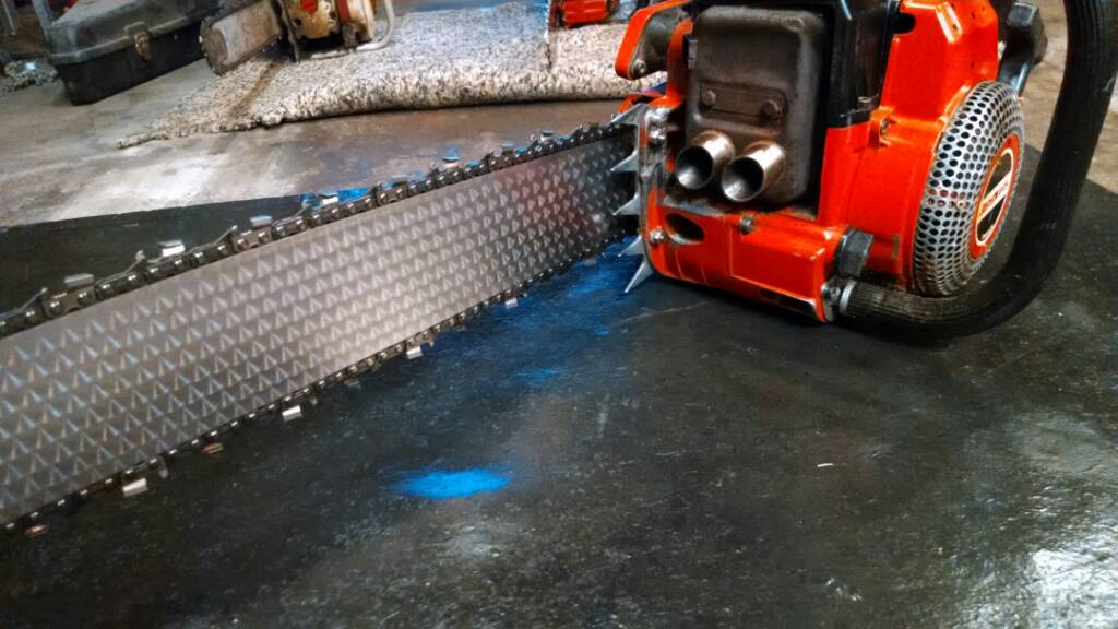

After the last layer was cleaned up under water, I blew the bar dry with compressed air and hit it with oil to stop the corrosion process.
If you dont you will be able to watch the rust form.
Sprayed on oil, gave it all a bit of a rub and polish with some fresh steel wool and then wiped it clean with dry clean paper toweling.
Fitted the new 404 tip and had fun taking out some inner frustration peening out the rivet.
Bolted it onto the 066 Red light, and am very happy with the result.
Damn, all I did today was cut the lawn! Nice work for sure and well documented. Now I have a guide and much better idea of the process so thanks for the info. I have 6 of them to do so I should be an expert by the time I'm done- Lol.

I have to say I am super happy with the blued finish.
The pictures dont do it justice.
I cant wait to see how it goes in some timber.
I am hoping less heat now that all that paint is off it.
Im pretty sure thats why Cannon blues theirs from the factory

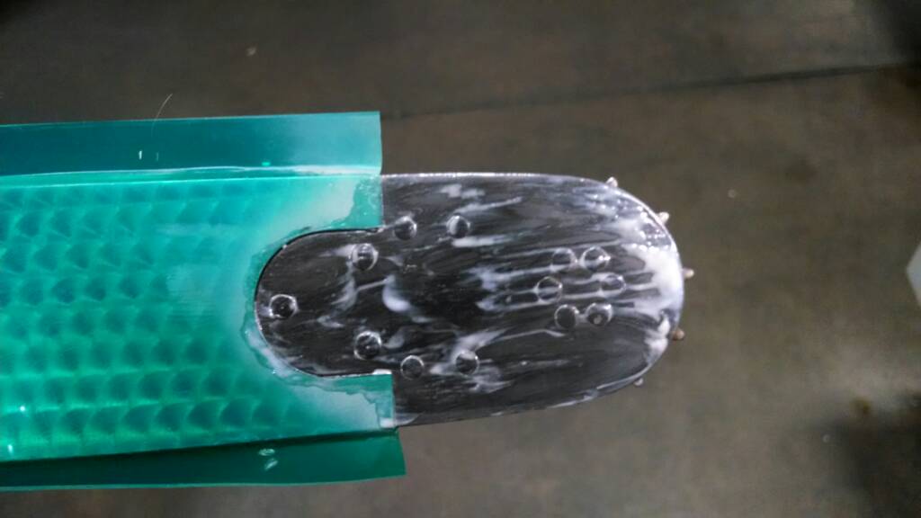

Scott, what is the texture of the bar after soda blasting? Sort of like sand blast or bead blast?

Hey Duane,
I have not had very many things blasted to compare to. This was my first go-around at having things soda blasted. I live in a boating area and fiberglass hulls are not easy or cheap to maintain. Soda blasting is all the rage at the moment because it's supposed to be easier on the material. The results do not look like what I have gotten with a wire wheel in the past. Don't get me wrong, the results are good, but not as clean as a wire wheel finish which is a bit shiney or polished looking by compairison. The finish is a little pitted looking almost like they are salt coated. I have been inspired by this thread and started my restoration process. After soda blasting, I belt sanded my 6 Stihl bars with 80 then 120 grit. Then wire wheeled them on my bench grinder. Then power palm sanded them with 240 grit (see pic). Next I will palm sand them with Scotch Brite pads and then hit them with "000" Steel Wool. Then onto the actual blue solution- fingers crossed. I will take a couple of close up pics of the bars and clutch covers as they are- untouched after the soda blasting to give you a better idea of the initial results.
