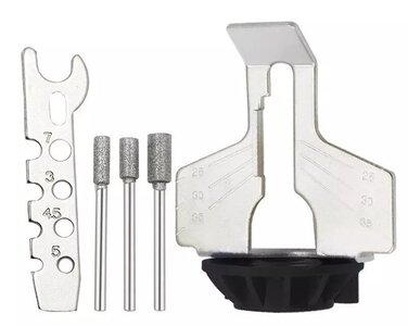

I even purchased a dedicated chain sharpening dremel type setup, with diamond burs and guide plate.
Didn't like it and passed it on to a neighbor, and his out of control dog chewed it to bits.
It was similar to this

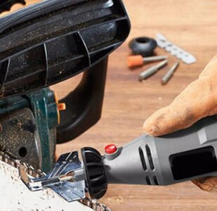

I got one of those.
I think they work great, well once you get the hang of using it.
I found very light pressure and a couple of strokes per tooth.
I do all the left or right cutters but from the same side. Eg. So the spinning diamond bit is pulling it down into the tooth. As I found it wants to jump out of the tooth and takes any hook out of the tooth. Your see what I mean when you use one a few times (one side will have no hook and the other will)
I don’t use the guide in the pic on the right, it got in the way and I couldn’t see jack-all.
However. I still use std files at regular times to help maintain consistency of the cutters as it’s very easy to over grind the teeth
