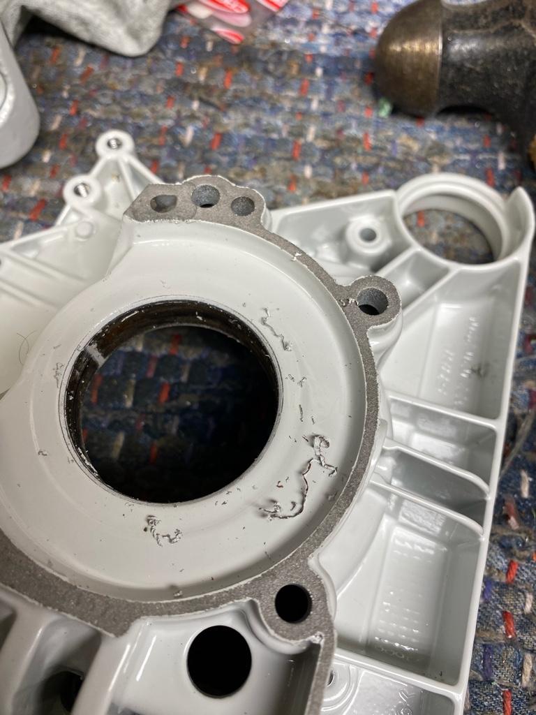

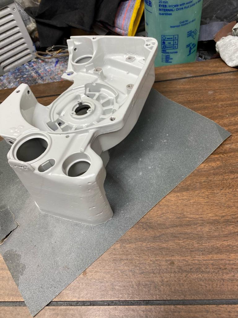

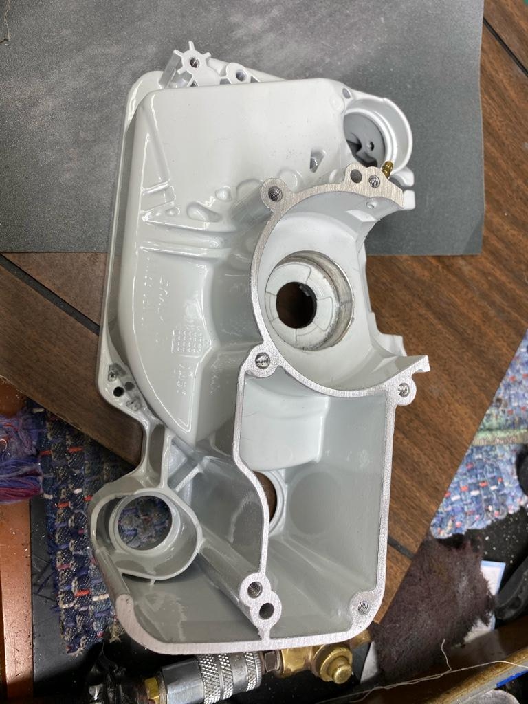

Start out deburring everything after powdering case

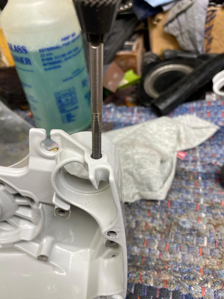

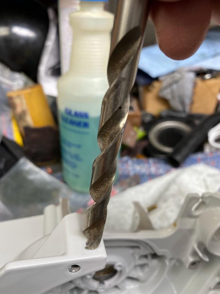

Use a drill with fingers cut the flash off plugged threaded holes
Then run a tap theu all threaded holes to remove dirt and powder from holes

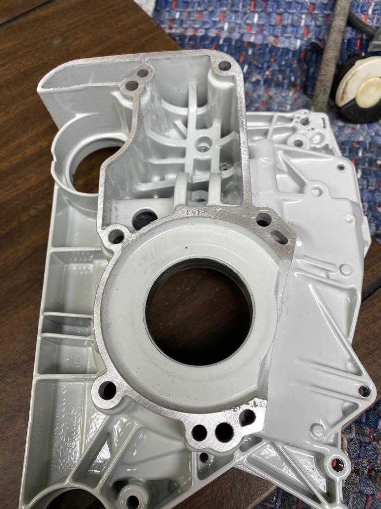

On a flat surface sand the mating surface flat with 320 paper doesnt take much but gives a nice surface to mate the halves together

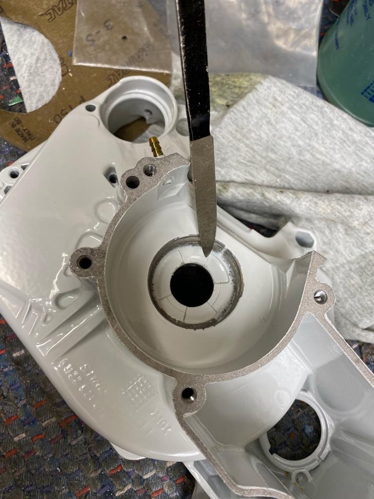

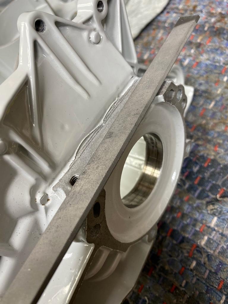

On the cylinder surface lay a file and file off the powder flash flat and any surface junk

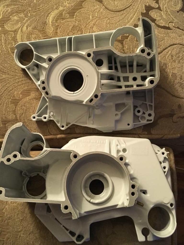

I just took a sharp old paring knife and trimmed all the flash off, ran taps through all threaded holes, and block-sanded the cylinder and case mating surfaces.
I took me about a 1/2 hour per case to get 'em cleaned and ready for assembly.
