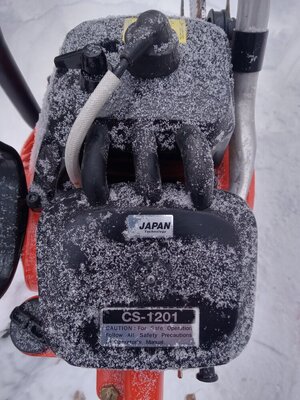

It is winter time and im surprised nobody hasn't mentioned the issues that come from cold weather ops. All Carburetors like warm air. There are over 2 dozen carburetors on various pieces of equipment around my homestead. They all get finicky in this constant 20-30 below zero weather.
I wonder if u couldn't richen your low jet, bring up yer idle to where the point where yer clutch "almost" engages.
Also, try to make certain yer winter setting is on, if the saw has one. Sometimes some extra heat on the carb helps immensely. Sometimes ill add a port to the engine cover to bring more heat to the carb. And also tape off the bottom third of my flywheel vents.
Here's one that needed more heat to the carb 3 hoses off the engine cover:
I’d move..
