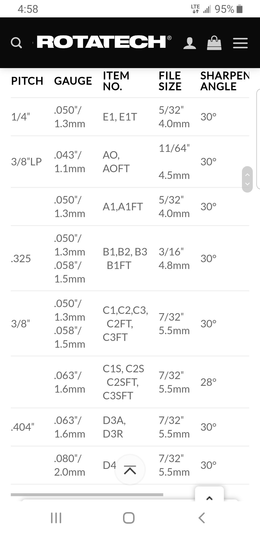

Here is a chart i found on line that may help with file size for differnt chain pitch.

Awesome chart I’ll print it! Thanks guys I’ve got a husky roller guide on the way! Are there certain chains the roller guide does not work on?
