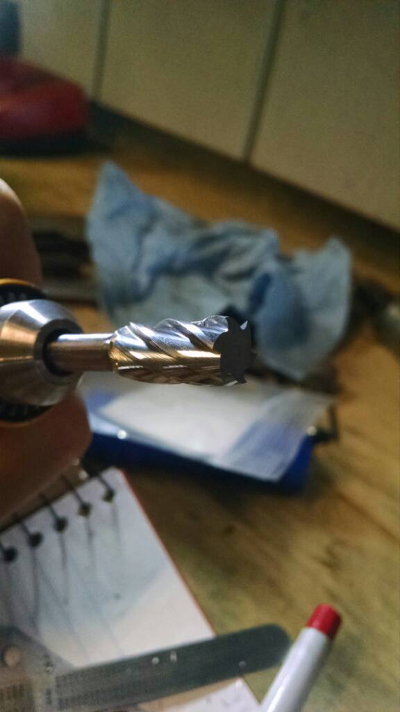

Here's my experience with the alumahog. Was going well until it wasn't... trimming back the extensions.
No comments necessary about my crappy port work.... slapped some yamabond on it,bolted it down..good nuff for who it's for.

Lol, that is more like an end mill!
Exactly...but it's the perfect profile to trim back the extensions, so I figured what the hell... might as well try it. It's works great if you can control it.
Pretty sure it'll eat your fuggin finger in a hurry though. So it makes me kinda nervous. Lol
I stay away from burrs with tips like that because it is too easy to snag the tip and jump all around. I normally use egg shaped or cylindrical with the rounded tip. I'll only use one like this if I'm trying to get a square corner.
I have used aggressive cut burrs like that one in an egg shape to rough in exhaust ports but I've switched to using high spiral ones for less chatter.

That burr will get one into trouble quick.
I do use something similar to get a clean square fingerport opening.
