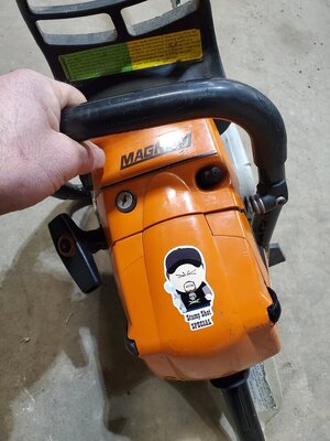

Because I pulled the strato valve off the carb, I'll install the carb next.
Fish the throttle cable through.
The end round ball is there for you to grab it.
The "barrel" is what actually connects to the carb.
Hook that bish up
Then pull the trigger a few times while making the required schwomp schwomp noise to verify the throttle actually works before going further.

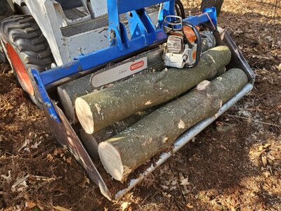

Only chunk of wood currently sitting around.
Starts easy, feels smooth, @Stump Shot did some mighty fine port work.
I'm super happy with the end results
