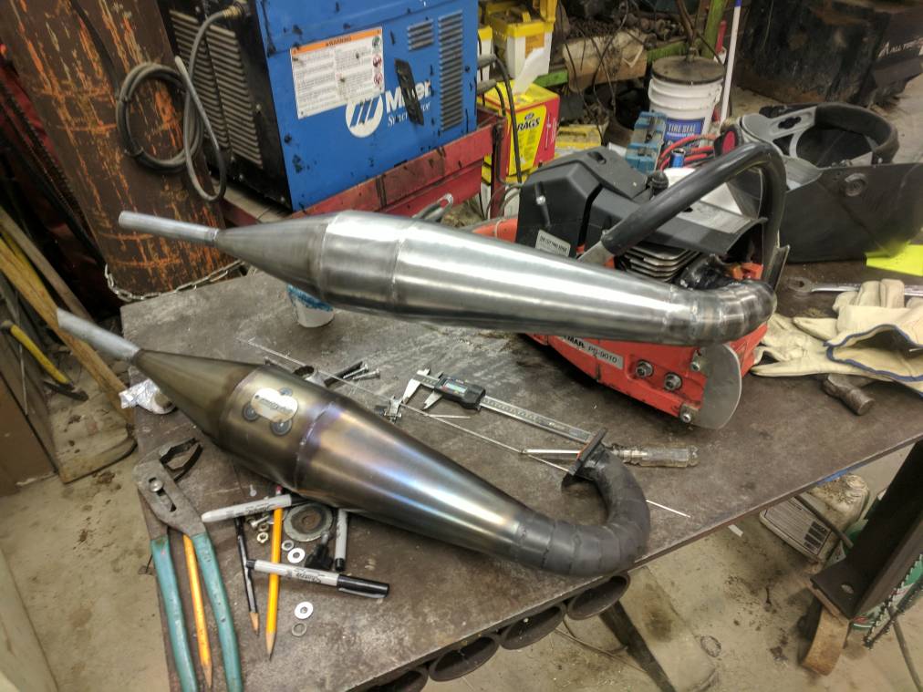

So made another pipe for Darla.....Little bigger dia in the header section and a little longer to bring the peak rpm down ....Looking for some more torque so it will pull more gear...Hopefully I can test it sat afternoon after a 6hr OSHA class at the fire dept
Sent from my Pixel using Tapatalk
