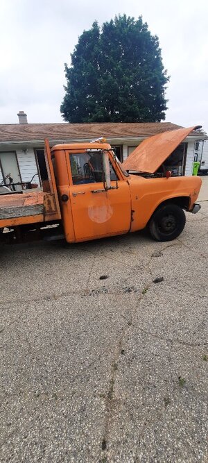

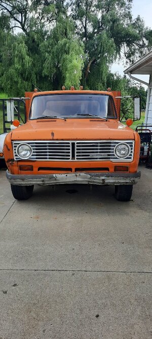

That weekend, I'm sitting on the couch drinking coffee, and the wife complains that she's bored and we should go do something. I jokingly asked her if she wanted to go look at an old truck and she says yes. Half an hour later, we are both walking around this '73 1310, which has a healthy 304 and a 4 speed. We called the number on the for sale sign, met up with the seller, and ended up making a deal.

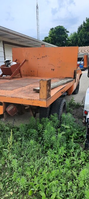

It is extremely solid for something that existed in the rust belt it's whole life. I figured this has a flatbed on it; It can pull double-duty as a farmstand and firewood hauler. I found a tag from Racine County, WI inside the cab for asset disposal authorization, which leads me to believe this was a county-owned work vehicle. They scrapped it out at some point, and the fellow I bought the truck pulled it out of the junkyard close to a decade ago. His stepfather and a buddy worked to get the engine running, and they had it running and driving around their farm eventually. Time passed, his stepfather passed away, and he was left to help his mother start cleaning up the farm... and now it's in my driveway.

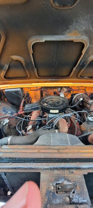

The first project I undertook was getting the carburetor rebuilt, as it was leaking fuel out of the float bowl badly, and the power valve was also damaged. This was pouring raw fuel into the intake and on top of the intake manifold.
I didn't take any pictures of the Holley 2300 when it was apart and off, so use your imagination. Picture a middle aged fat guy and his son scrubbing a grody carb in the parts washer and then alternating between the ultrasonic cleaner and compressed air.
The previous owner installed an electric fuel pump which I plan to replace with the factory mechanical pump. Parts are available online, and I assume they couldn't find a replacement for original pump so they just went electric.
With the carb cleaned and rebuilt, the engine starts, idles and runs wonderfully.

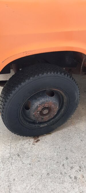

These trucks used a 16.5 rim, and tires are difficult to find. There are a few options online, but the tread selection is very limited. I want to put a good steer tire on the front, and something more aggressive on the rear for traction for when out in the woods hauling wood.
I'm currently reading up on other make/model rims that will fit, as a 16" rim will provide far more tire choices. It seems that late 80's/early 90's ford and dodge rims will work, and if they came from a dually the offset will be correct.
Has anyone else here owned an IHC truck and swapped to a 16" rim?

My understanding is that late 80's and 90's ford, dodge and chevy all had 8x6.5 bolt pattern for the rims the only difference between brands was the diameter of the center hole. You should be able to search the measurements online. I have looked it up before but can't remember now what they are. Very neat old truck! I love 60's and 70's Fords and Internationals!
This was my understanding as well, but it's good to hear it from other sources. I'm hoping to move the truck to a better spot today so I can pull some wheels off and measure things accurately prior to wheel "shopping"
They all had the same bolt pattern back then Ford had the biggest center hole.
Dodges had a pin on the wheels and hub you had to line up. I have the same truck with 16” split rims on it. Try to find an RV scrap yard for rims
There are a few decent salvage yards near me, and I will be contacting them after I talk to a guy who may have a full set I can purchase. What truck do you have? Got any pictures?

I did a quick search of 16.5" truck tires and was amazed at the amount of options that came up om Amazon. You don't need to change rims if you do a very simple search online for 16.5" truck tires.
Ken
I did find tires online, yes, but if I was in a pinch and needed tires today, local shops are unlikely to have anything in stock.
Edit, did you happen to click on any of the tires on Amazon and check the actual sizes? There are like 4 options, and 3 of them are bias ply

Bias is probably fine or even better.
Realistically, anything is better than the dry rotted bombs that are on the current rims.
I have had bias ply tires on 2 other vehicles and had issues with flat spots if they sat overnight. Knowing that this truck isn't going to be daily driven, I'm hesitant to go the bias ply route based on my previous issues with them. I like my tires to be round, and this old one ton will ride rough enough...
