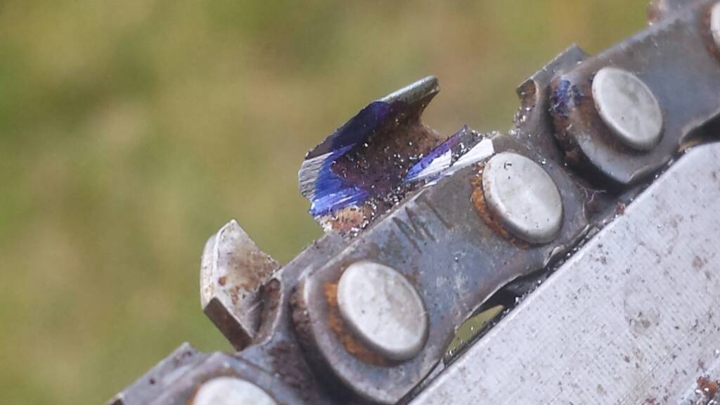

I submitted a 3/8 72 dl Oregon simi-chisel chain that I sharpened on the R2 for the round 4 buildoff. I knew it cut well, and wanted to see where it would end up vs all the other chains. They didn't get a chance to run the 3/8 @ the GTG though. Here's what the cutter looked like.
Had to round off the corner of the grind wheel too get this profile, but you can "make" IT work.

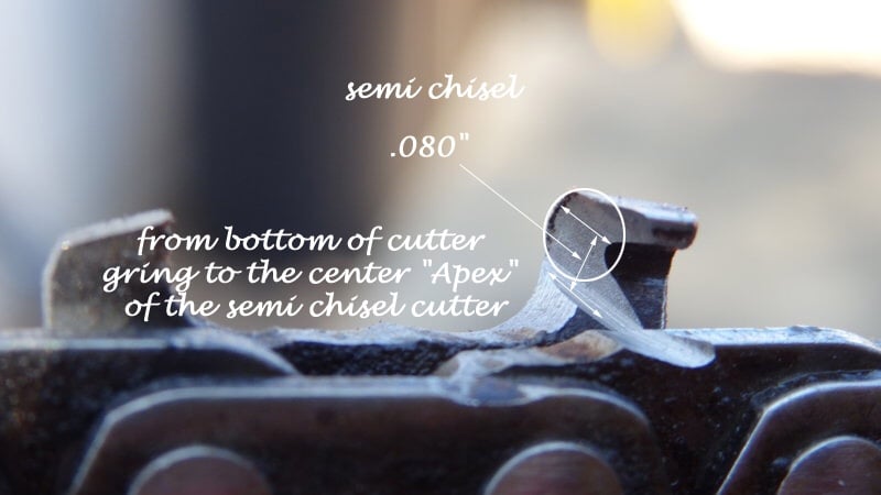

You can get a flat ground top plate cutting edge by just grinding with the side of the wheel, instead of a round profiled end. You can get something similar with a 'goofy file'. But you can't get the corner, because it does not exist on semi-chisel chain. The corner is part of what makes square ground/filed full-chisel chain faster.

Square grinding or bevel filing a semi chisel chain will only make the top plate sharper and fragile. Not the intended purpose of the cutter to begin with. There is no outside corner for reference. It would be a crap shoot.
Take a look at the relationship of how much a square vs semi bites on the outside kerf, beyond the raker.;). Different forgings.
