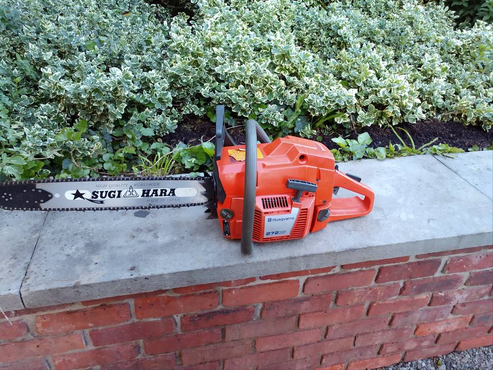

They're great running saws. This old girl is completely stock and puts a smile on my face.
Nice!! How do you like that bar? I’m always looking for older stuff to buy, it’s just built better and easy to fix.
